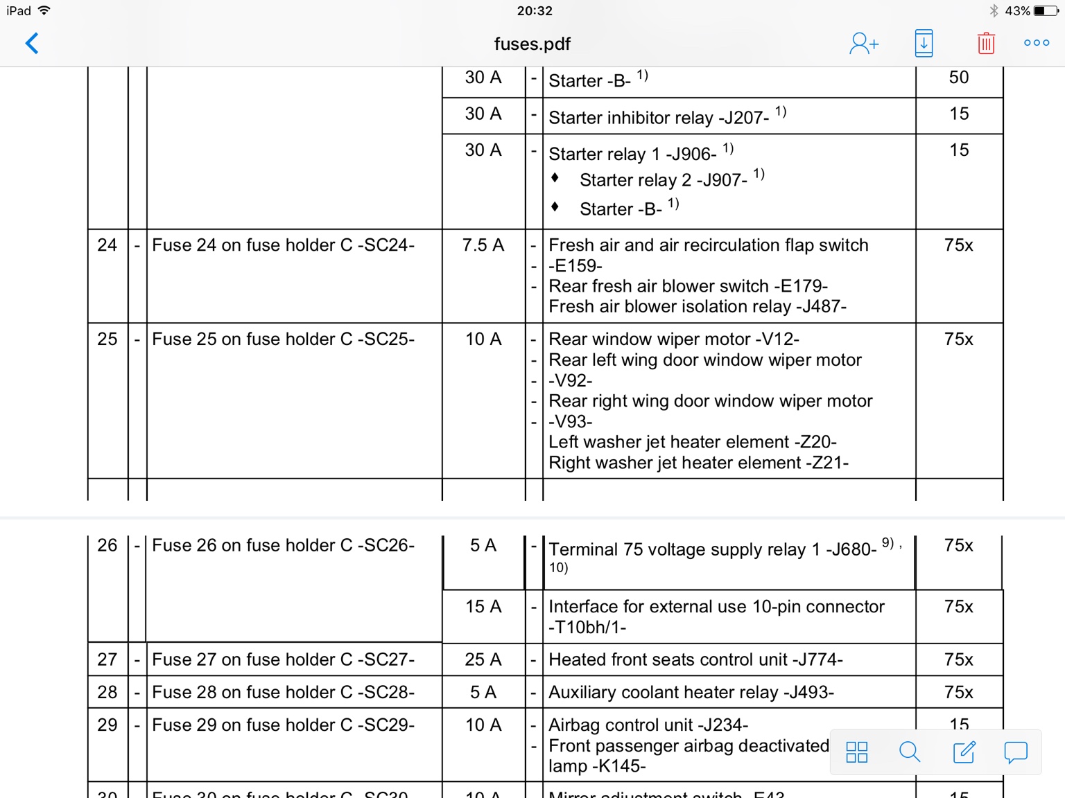

Hi all,
I noticed on the way home tonight that my rear window wiper isn't working - it's stuck in the vertical position and won't move, even when to squirt the washer. I assumed a fuse must have gone but when trying to work out which fuse it is have been flummoxed by the fuse box! From looking in the guide in the download section I think it is Fuse 25 in holder C - but I can't see which one that is? The guide says it should be a 10 amp fuse - I've checked the two small ones up the top and they are fine. I can see there is a standard size 10amp fuse down the bottom and I assume it's that one - however as simply cannot get my hand to it with the little fuse pullers to get it out and check.
Can anyone give me any guidance please on which fuse it is and if it is the one right down the bottom then how on earth I can get it out to check?

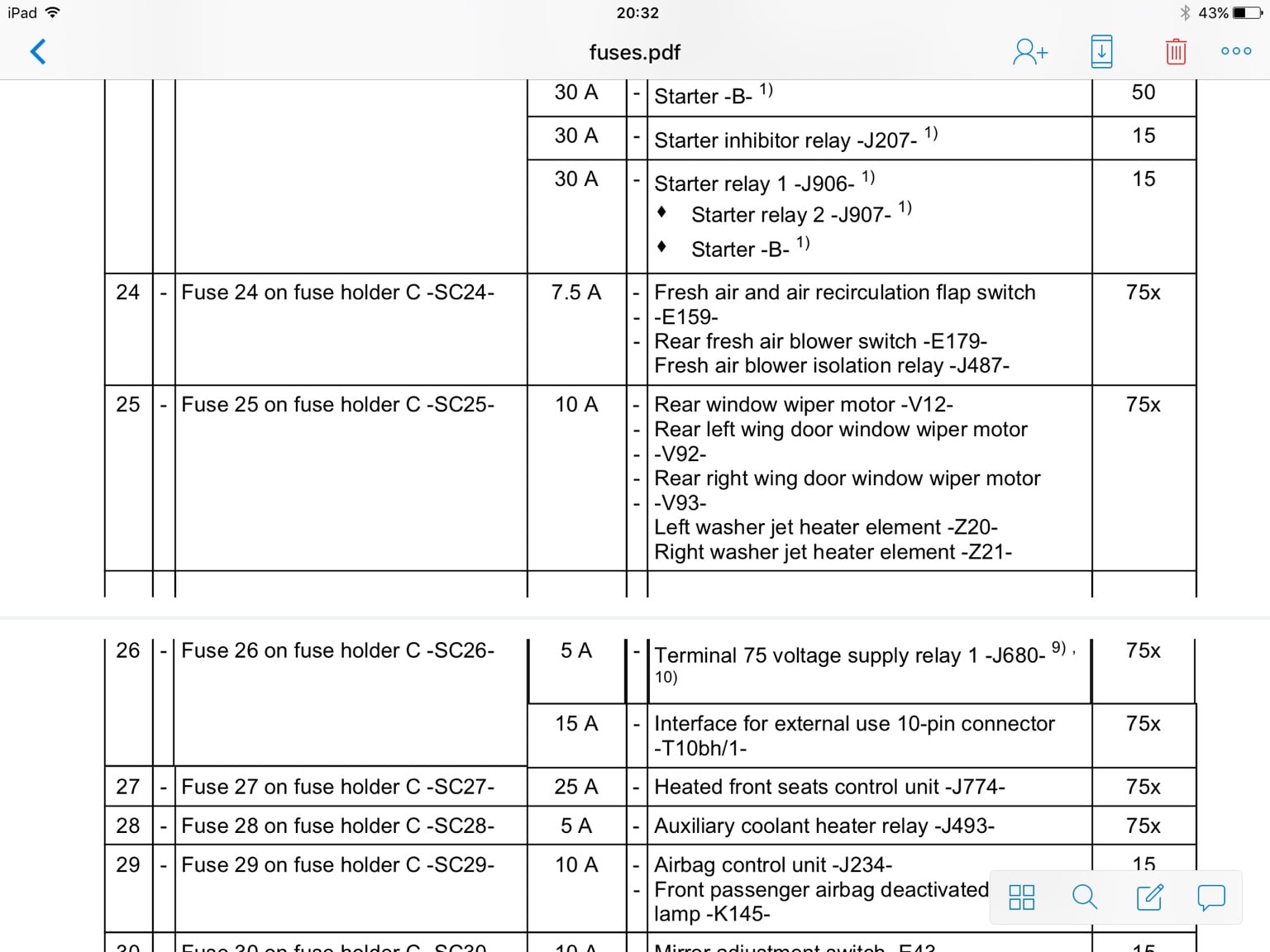

Don't listen to me as far as electrics but here is a screenshot and it seems to confirm it is as being red and 10amp

Thanks Mike. How do I tell if that is Fuse 25 right down the bottom and how on earth do I get to it?
If you have the Fuse Download from the VIP Download section.
Page 15 shows the description for each Fuse. However, on Page 13 it shows the layout. Numbering from Top Left is Fuse 1 numbering Down L side , up from Middle bottom. And then down R side.
Bottom Middle is Fuse 23. So 2 up is Fuse 25, and that is a red 10 amp.
You may have to remove the lower trim to gain easy access.

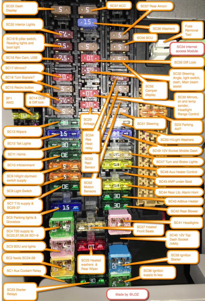

Patent held by @Loz
Cup holder fuses
Bottom middle
Mike
Hi Bart,
Yes replacing the fuse fixed it - but reaching it was a real bugger! Involved lots of swearing and trying to squeeze fingers into gaps. Really need some kind of right angled pliers to do it if such a thing exists - I managed it in the end with my fingers but it took ages and the air was very blue!!!
