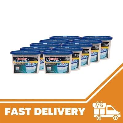

I use Disposable Dehumidifier Canisters, 2 in the van all year, changed over when full. Amazing how much water they collect. Available on line or any good hardware store.

I use these. There are different brands from different companies. I use the cheapest.
If they tip, collected water doesn’t spill.
I like this idea ,where do you put them in the van.
Out of sight. I have one in the base of the wardrobe, next to kitchen and one under drivers seat. Doesn’t really matter where they are.
