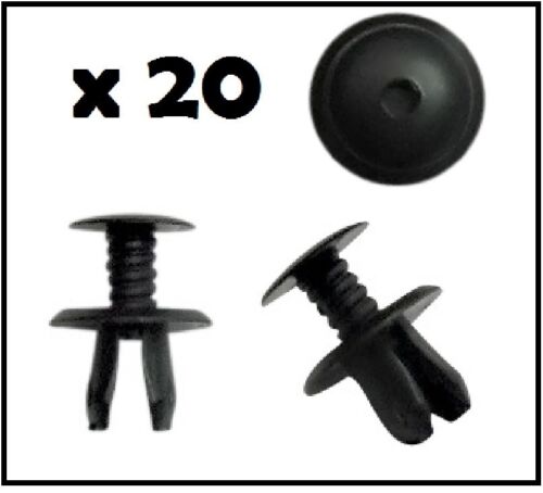

I need to remove zipped pocket to gain access to inner tailgate.
Does anyone know how to remove the plastic rivets?
What tool do i need?
Part number of replacements?
See attached photos.
They look similair to those in my T4. If I am not mistaken these are the ones: clips You can take them out with something you guys in England call an allen key. If you're lucky and take it slow/cautious, you can re-use the same ones. If not, you can buy them in bulk from chinese websites or more expensive from local carpart-shops.
My website is in Dutch, but there are pictures of me removing these clips with an allen key here.
The are torcx or allen key i think.
A turn or two then a good finger nail
T4 is sold, T5 is getting checked at the garage, so I can't try it, but quite sure it was 3mm allen key, if I remember correctly. It's important to not use to small a key and not too much force, or the allen-key will spin inside the hole and seeing how they are cheap plastic clips, the hole will widen and it will get more difficult to remove the clips. When you turn the allen key, the first part of the clip will come out and the second should follow. If you don't get them out, another solution is to screw a screw into the allen key opening. The screw will screw itself in and youll be able to pull the plug out. But that means you will then have to rep[lace the clips.
I find they round off very easily but can be popped out with a forked trim removal tool like this one and just pushed back in. I got a whole set of the tools for about £10 from amazon.
When prising out you need to get in between the 2 bits of plastic and not try to remove the whole thing at once.
that isa good kit to have, i think i will stick that on my christmas list.
Just pull the centre part directly out by 10mm using mole grips or pliers holding a small nail or spike that has a 90 degree bend about 5mm from the end. An Allen key won’t remove them.
Cheap enough on eBay if you wreck them:
No. Do not use an allen key to attempt to remove these...they will simly deform in position.
These plug rivets are removed by using a pick tool. I bought a set from Screwfix. Halfords also sell them.
I found that the 90deg version worked well.
Check out this youtube video.

I have these holding the fairing and other bits on my motorbike - allen key and they pop out. They can be reused by popping them back in.
