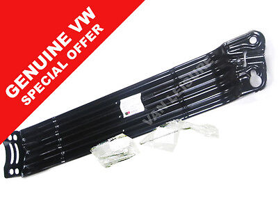

These people can supply.

What size wheels do you have?
You can easily fit a spare wheel carrier but it will only easily fit 17" wheels + appropriate sized tyre. If you have larger diameter wheels you could use the 17" spare as a get you home space saver, limited speed and limited distance.
I've got 17" wheels for summer and winter so no issues there. The van also has the brake upgrade so needs 17" spare - 16" won't fit
So no problem then. Parts can be sourced from VW or other suppliers, as detailed above or the Forum Shop.
17" wheel/tyres are wider than the 16" ones.
To fit the 17" in the rack it has spacers to lower the rack rear (bumper end). The front (on my T6) has selectable hinge pin slots.
UK supplier who may ship complete kit.
