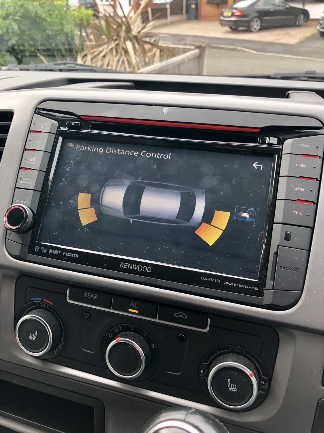

I had the kenwood dnx518vdabs fitted a few weeks ago.
Parking sensors work perfectly.
You get 3 free map upgrades using the SD card slot and 2 years free traffic.
Apple car play included, along with webplay which allows you to play YouTube videos (not sure I’ll use that).
