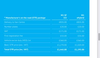

VWs current brochure also confirms the £360 for both ICE and hybrid :-
If you actually look at the pricing above it actually doesn't calculate properly.
