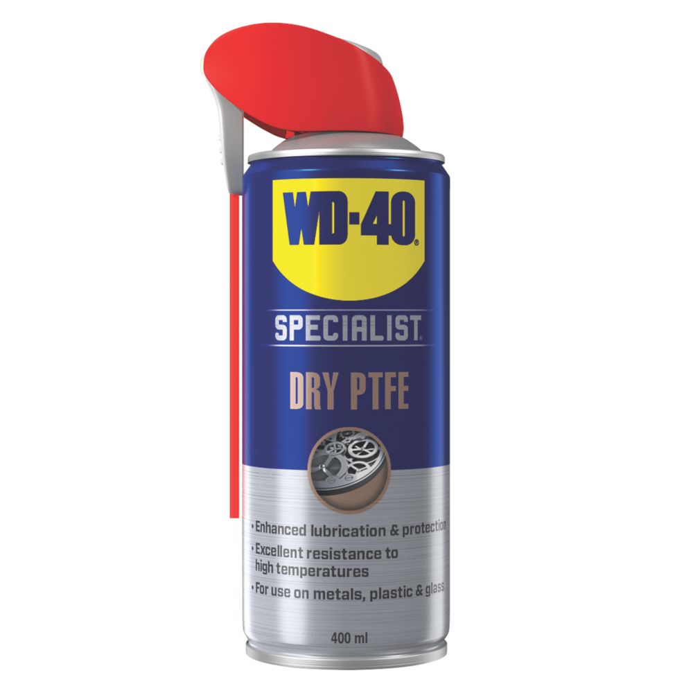

Instead of spray silicon use this dry PTFE spray ... Great on the side door rails as well!
Cheapest from Screwfix :)
