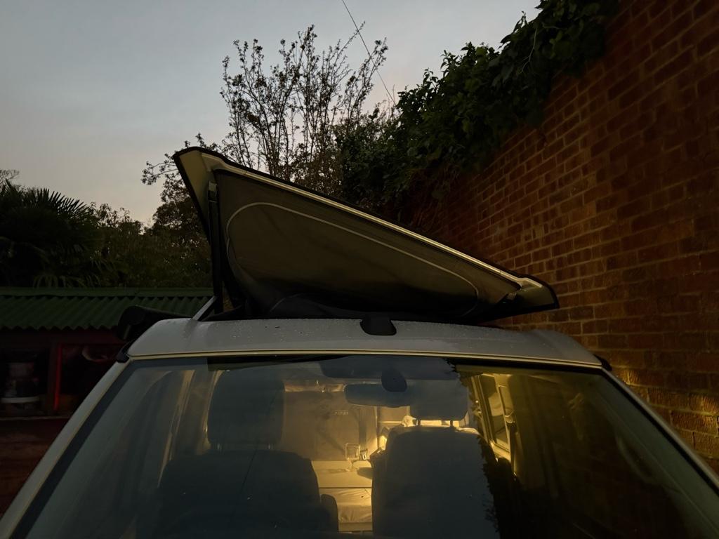

The roof on my 6.1 has started to close left side before the right side when looking from the front. The difference is about an inch or just over. I am pretty sure that it closed evenly before.

Hi BC, both our Californias have over the years had days when the roof closes ‘unevenly’ with no particular long term issues. As long as it’s not much more than an inch or two don’t think you need to worry. If the roofs up a few days one side or other can sag a little (lose tension) or if you are parked on a slope or up on ramps this can have an effect, again if only a couple inches off level not particularly unusual. If at any time you are a little concerned while lowering just stop half way down and then put it fully back up to full tension then bring it down again should be pretty square at that point. Re the high pitched noise at end if raising and lowering this is normal if it’s the hydraulic pump you are referring to.

This evening, while proudly showing off our new Cali to a T2-owning relative visiting from Yorkshire I was putting the roof down - went outside for the ‘half-way down check’ and was shocked to see it had come down very unevenly.
I hadn’t been able to tell from inside, and it didn’t make any unusual noises. It was definitely not fouled on anything, and the van is level on our driveway.
We had the bellows replaced last month and have only been away with the roof up for one night since then. No issues at that time.
I put the roof up again, and brought it down with wife and relative watching outside. It came down fine this time, with the nearside perhaps an inch or two ahead.
I’ll put some PTFE spray on the runners, but will this have done any damage? Should I be speaking to the dealer, or just ‘see how it goes’?
