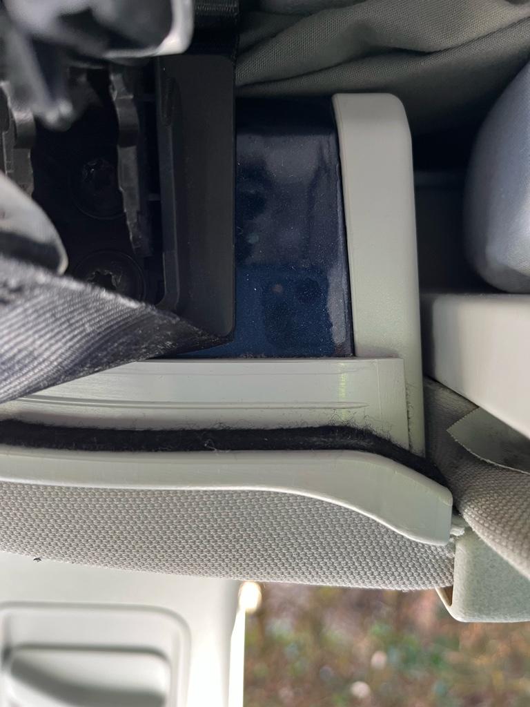

I managed to solve the problem of the screw blocking.
Could someone kindly measure the distance I indicate in the photo with a meter and tell me?
Thanks
On mine I make that 4mm.
Bottom of plate (not including the fabric) to base of plastic channel.
