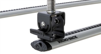

This is ideal but soooo expensive but a little cheaper (but not much) than a karitek option.

Why do they only seem to make these things in australia lol
