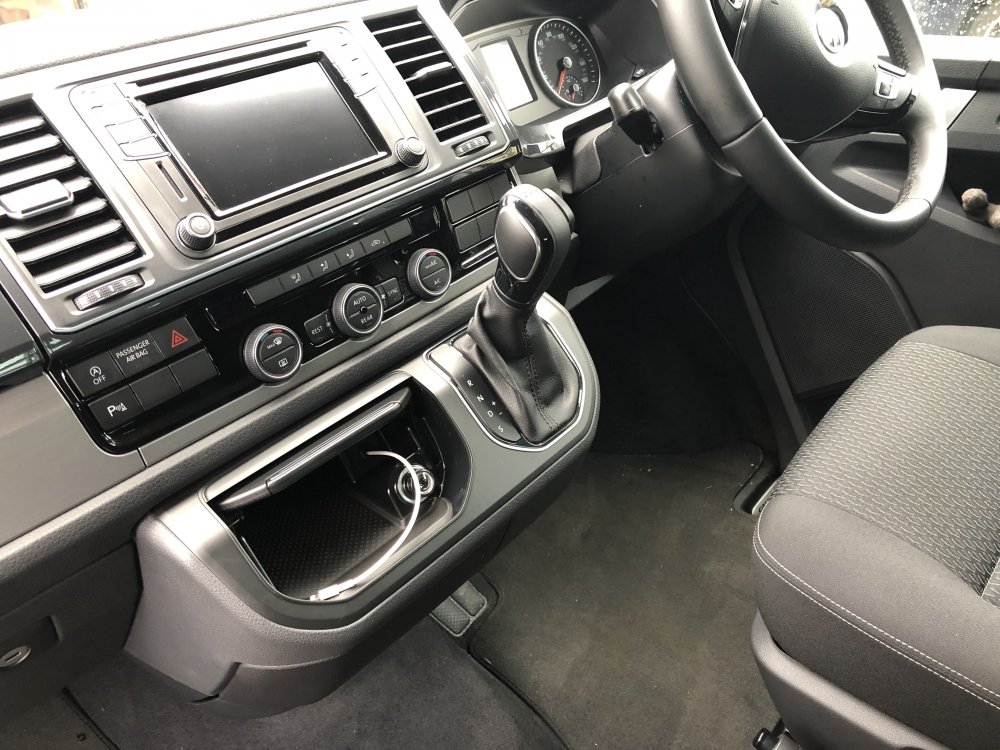

I'm not at home but this is a picture I found on the web showing the cubby with the socket fitted. Mine is just like that but with a blank fitted.
I figure I could just run a cable through that blank (with a rubber grommet) and pass a cable through it which would be plugged into the top glovebox USB socket. It would be better in some ways as there wouldn't be a long length of USB cable stuffed in the cubby.

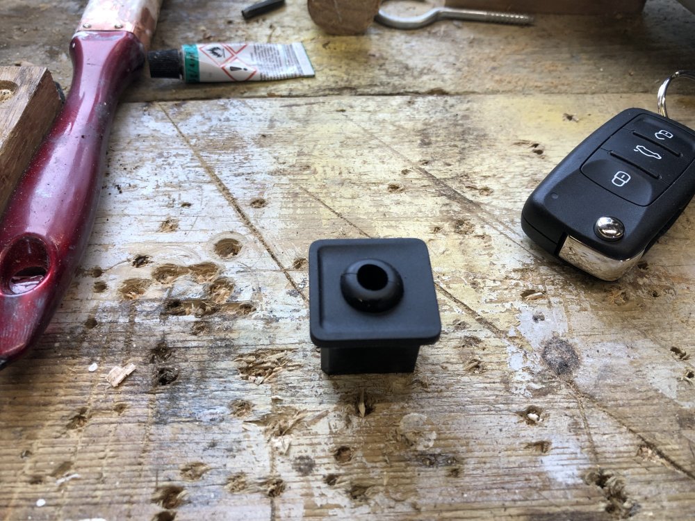

Blank removed from cubby, hole drilled and grommet inserted. I had to remove this again to get the cable through but I wanted to check that it fitted.

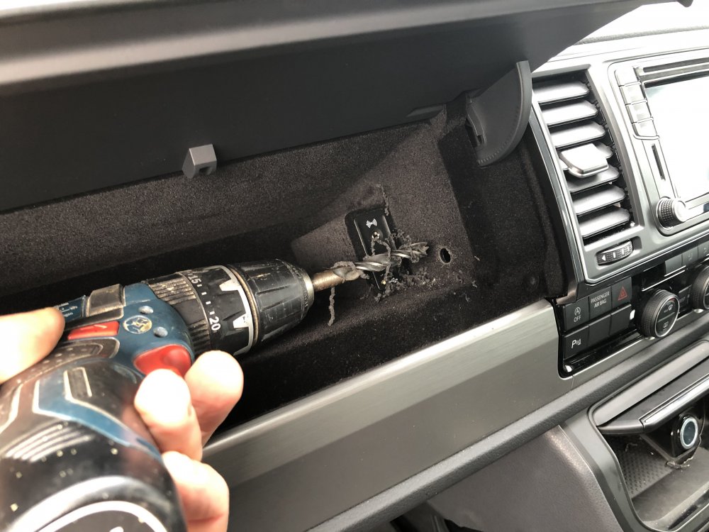

Carefully drilling hole in the side of the glovebox (there's nothing important right behind this bit) after picking a drillbit that wouldn't pull through the material too aggressively.

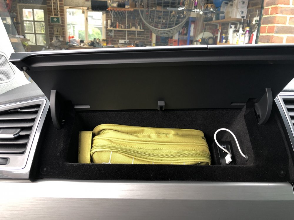

Cable plugged in and routed with grommet.
