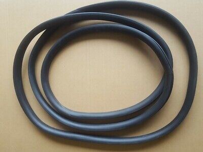

Front door rubbers available from multicoloured auction site.
avoid getting non OEM slider door seal as the profile is different from the front door (despite sellers advising otherwise), just kampers etc.
the club shop will probably source them for you.
Your dealer parts department will be able to provide part numbers and costs (you will need to ask for the part numbers).

I bought them from justkampers,
Part J19335 and J19336. Bit pricey compared to auction site, prices gone up about £20 since I ordered.
Just to circle back on this - I've decided to go ahead with this option; should work out at ~£160 all in for all 3 seals (that's for a combination of OEM and non-OEM seals):
2 x door seals. Non-OEM but reportedly a good fit and half the price of the OEM ones. £34.99 each from JustKampers https://www.justkampers.com/7e0-837...-door-seal-inner-t5-2003-2015-t6-2015-on.html
1 x Seal for sliding door. OEM part number 7E0843792 (quoted at £90.60 from breeze parts dept) is ~£79 inc P&P from LLL Parts https://www.lllparts.co.uk/product/vag-seal-for-sliding-door-7e0843792/mpn/7e0843792

First up, I would describe my maintenance skills as novice. If I can copy a YouTube video or have clear instructions then I’ll typically give it a go with some success, so bear that it mind while reading my conclusion below:
- Non OEM seals are cut to length and will therefore have a split at the point you cut. This is the material difference from OEM which are one continuous/joined piece of trim. I used non OEM for front doors abs OEM for the sliding door
- Driver/passenger door seals are not too challenging. Go slow when prising plastic trims away, use trim tools designed for the job (kits are readily available from Amazon) and have patience.
- I had to admit defeat for the sliding door seal. I just couldn’t figure out how to remove the upper trims sufficiently to allow sufficient wiggle room to get the new seal into place (old one does pull off easily). The restricted space caused by the blackout blind was too problematic. I therefore went to a local garage/indie who had a look. However, I stopped them proceeding when they declared that the whole rear bench would need to be removed to allow that whole OS trim piece to be removed (didn’t feel logical to me). At this point I admitted defeat and gave it to VW at Breeze who fitted the seal I provided them at the cost of 2 hours labour. Not cheap but I’m happy to have brand new seals on all points of entry now and it looks very smart. Perfectos didn’t have to call in the cavalry and managed to do it himself, plus he was very generous with instructions to help me at various stages. It may be notable that he completed the job on a T5.1 Kombi rather than the T6 Ocean and I do wonder if the enclosed blind and trim pieces differ slightly.
