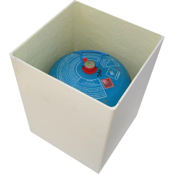

From a safety point of view I would take the regulator off and fit the screw on handle. A bucket is a cheap holder option!
