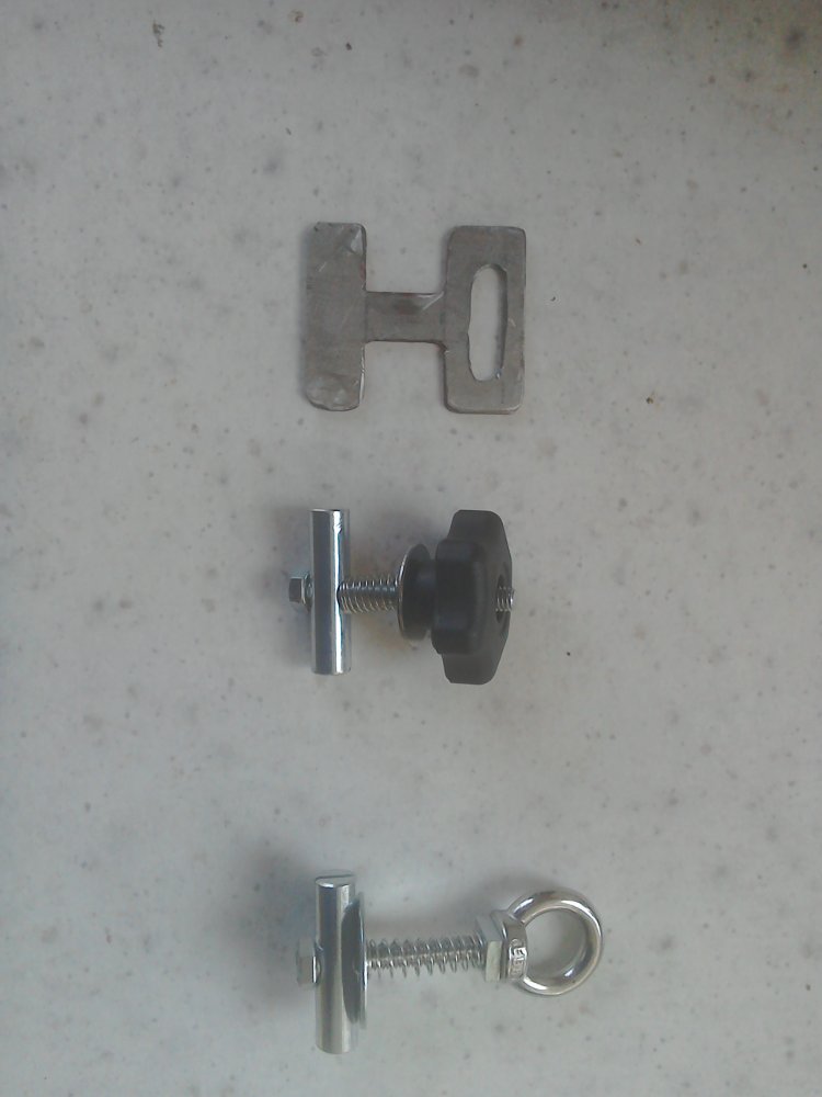

As promised.
Three home made fixings.
Top - cut from 3mm plate, slots in to rail, turn through 90degrees, bottom catches in notches on rail, loop strap through slot for really firm front to back strapping.
Middle - used as a pair with brackets to fix dog cage to rail.
Made up of 60mm M6 stainless steel bolt (screwfix £1.99 for 10) with 40m barrel bolt/dowel (larger version of the ones you find in flat pack furniture) eBay, a large washer, spring and a knurled knob (eBay again)
Bottom - similar to above with tie down eye (eBay) to loop bungee.
They all work, and cost very little.

I can't be sure these are the people I ordered from as it was last summer and I can't find the order history, but these are the sort of thing.
Cross dowel nut M6 40m
http://www.ebay.co.uk/itm/M6-x-40mm...re-Hole-for-furniture-Beds-Cots-/222031886589
Knob nuts ;) yes that is the search term!
http://www.ebay.co.uk/itm/M6-Female...546585?hash=item1c59caca59:g:l6QAAOSwnipWaehc
Lashing eyes
http://www.ebay.co.uk/itm/M6-M8-M10...hash=item1c55be726e:m:mpNxSCiCaU8ZcKOtRDK5M1g
You may be able to get them in other places which may be cheaper.
The mark 1 version of the knob clamp has a slot cut in the top of the bolt so you can see the orientation of the bar in the rail. The mark 2 version (yet to be prototyped) will have a 60mm bolt and a wing nut fixed to the top for the same purpose.
