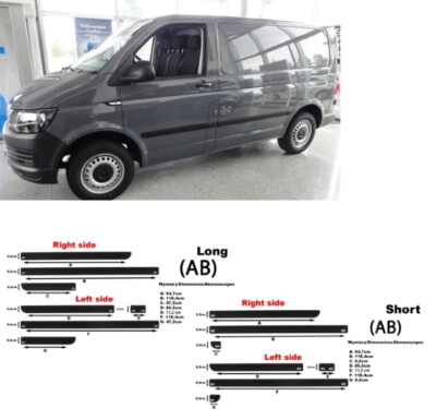

I think your Dealer is talking rubbish, I’m afraid.
All the parts would fit, both sides apart from the small piece around the fuel flap.
On the T5 this piece fits immediately below the opening flap.
On the T6 the Fuel flap is taller and I cannot see why the piece cannot fit on the opening flap, at most the rear end of the flap would have to be tapered so the flap would open fully, or you could just leave that section off.
I think that the flap goes further down for the Adblue filler which is why the T5 doesn't fit the T6. I would have thought that the moulding could be cut at that point to suit. dealer wouldn't do that though. Care needed to check fitting as to Cali offside sliding door not as in UK Transporters near side one.
Doesn’t make any difference, which side sliding door is. The mouldings don’t extend to the rear panel/wheel arch. The 2 rear sections are the same length. The Front sections are different. 1 long and 1 short on Passenger side as Fuel flap cuts into Door opening Drivers side is equivalent in length to the 2 pieces from Passenger side.
It did with the chrome side strips which was what I based my mistaken advice on.
Those ones you were looking at on eBay, are Handed because they go onto the rear panel/wheel arch unlike the VW ones.
