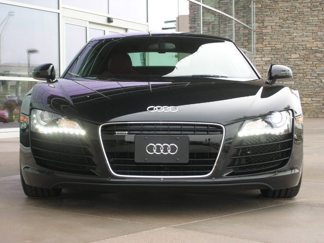

These are the drl's surely

Those are not the sidelights,, those are the DRL’s, Daylight Running Lights.
By EU regulation, since 2011, all new vehicles sold in the EU had to have DRLs that come on automatically with the ignition.
You also have Parking (sidelight) lights, Front and rear that can be used with Ignition Off when parked.
