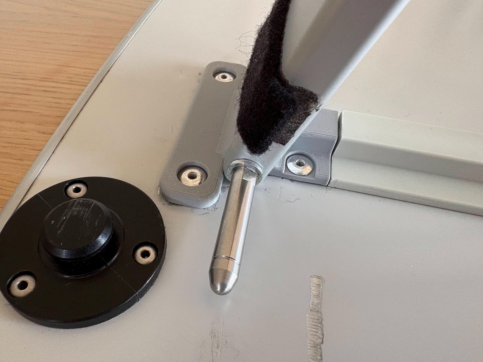

Still got a bit of work to do on this (Christmas etc slowed down my progress) but hopefully will get it sorted by end Jan. See pic of bracket.

I think I have a workable solution. This involves sawing off the broken bit of the bracket but leave the rest intact as this controls the sliding link (and does not break). The repair is shown above in this thread where an aluminium replacement is glued on.
The strength of the repair is down to the quality of the glue and the preparation to get a good bond. As I said above, I tried different glues and preparations with considerable variations in the final strength.

As far as I can see, there are quite a few inventive solutions to repair this damage, which is the result of a design flaw and of which VW cannot be very proud at such high California prices.
The damage to the PVC hinge was not such that the table could no longer be used but, rather, there was always the fear that the thing would break off by the end. At best I tried to glue the crack with a two-component epoxy glue, but the thing lasted only a day or two. Then I turned to a friend who is a welding specialist and he solved the problem for me with an INOX adapter he had made himself. I found the solution interesting because it didn't require drilling or installing rivets directly into the undersurface of the table, but the adapter was riveted to an old PVC bracket. Only the damaged cylindrical part was removed.
It is quite clear to me that not everyone has the possibility of repairing this damage in this way, but I am nevertheless attaching photographs of this solution.

Congratulations, neat fix. Would you sell a piece of this? Thank you
