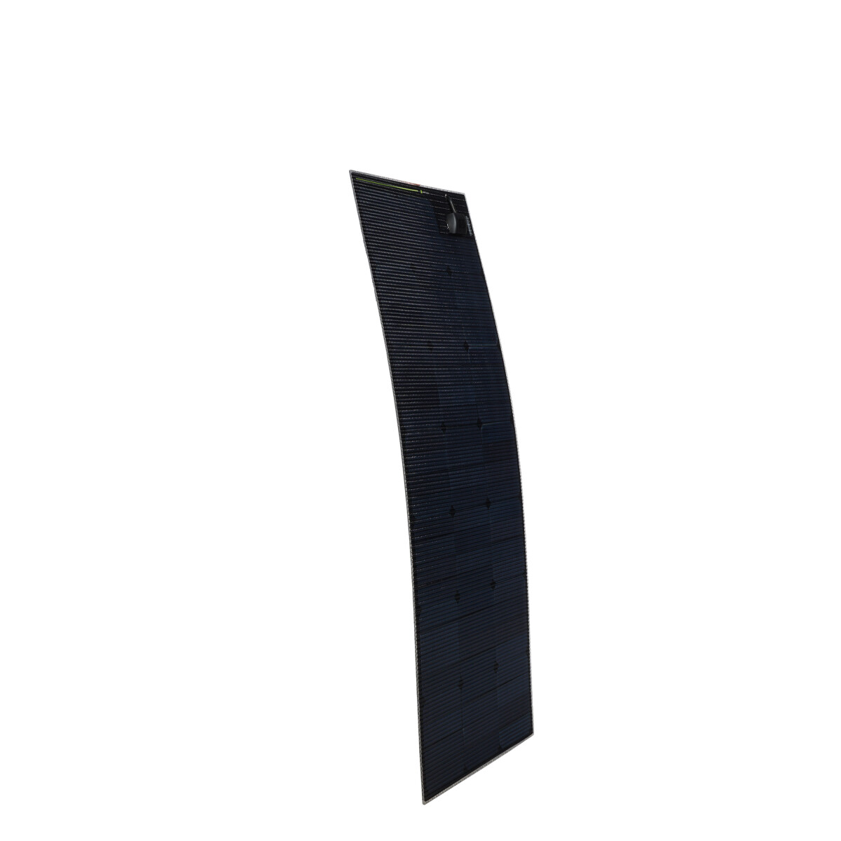

To keep the height as low as possible then using 3M VHB tape to attach a fairly rigid marine grade panel to the pop-top roof seems to be the way to go. Preferably one with an aluminium backing plate.
I'm tending towards a pair of these which would give me 250W ...
... and the fitting instructions say they can be stuck directly to corrugated pop-tops with 3M Tape. :thumb

Update .... after much messing around with panels, panel carriers etc. this is the way I have decided to go with a 310W setup ...
Parts List:
2 x Phaesun 310424 MARE FLEX 155 ETFE 155w Solar Panels
1 x Hess Campers 320W Solar mounting plate
1 x Scanstrut DS-H10-BLK cable seal
1 x Aluminium cable conduit 110mm x 50mm x 20mm
1 x 3M VHB Tape GPH-160GF, Grey, 25 mm x 33 m, 1,6 mm
1 x Victron SmartSolar 100/30
1 x 2 pole circuit breaker for isolating panels
1 x 40A waterproof circuit breaker (MPPT to Batteries)
Looks like this ...
