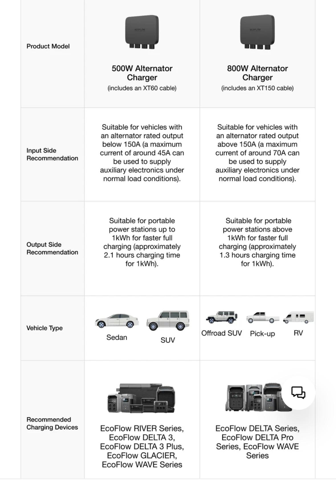

The new EcoFlow alternator charger, released this week can charge other devices now, not just the EcoFlow range, 500watt now instead of 800 with Xt60 connector.
Is your alternator charger connected to the leisure battery? If so, you should be able to hook up the van at home and charge the Ecoflow without removing it.
Sort of, it’s connected to the split charge relay, it’s hard to run the cable to the van, hence just pulling the EcoFlow.
Do you mean with the new firmware update? I updated mine yesterday and it now has that feature. Just need to buy an xt60 cable.
No, there’s a new charger out as well. 500watt with the cables for other devices.
