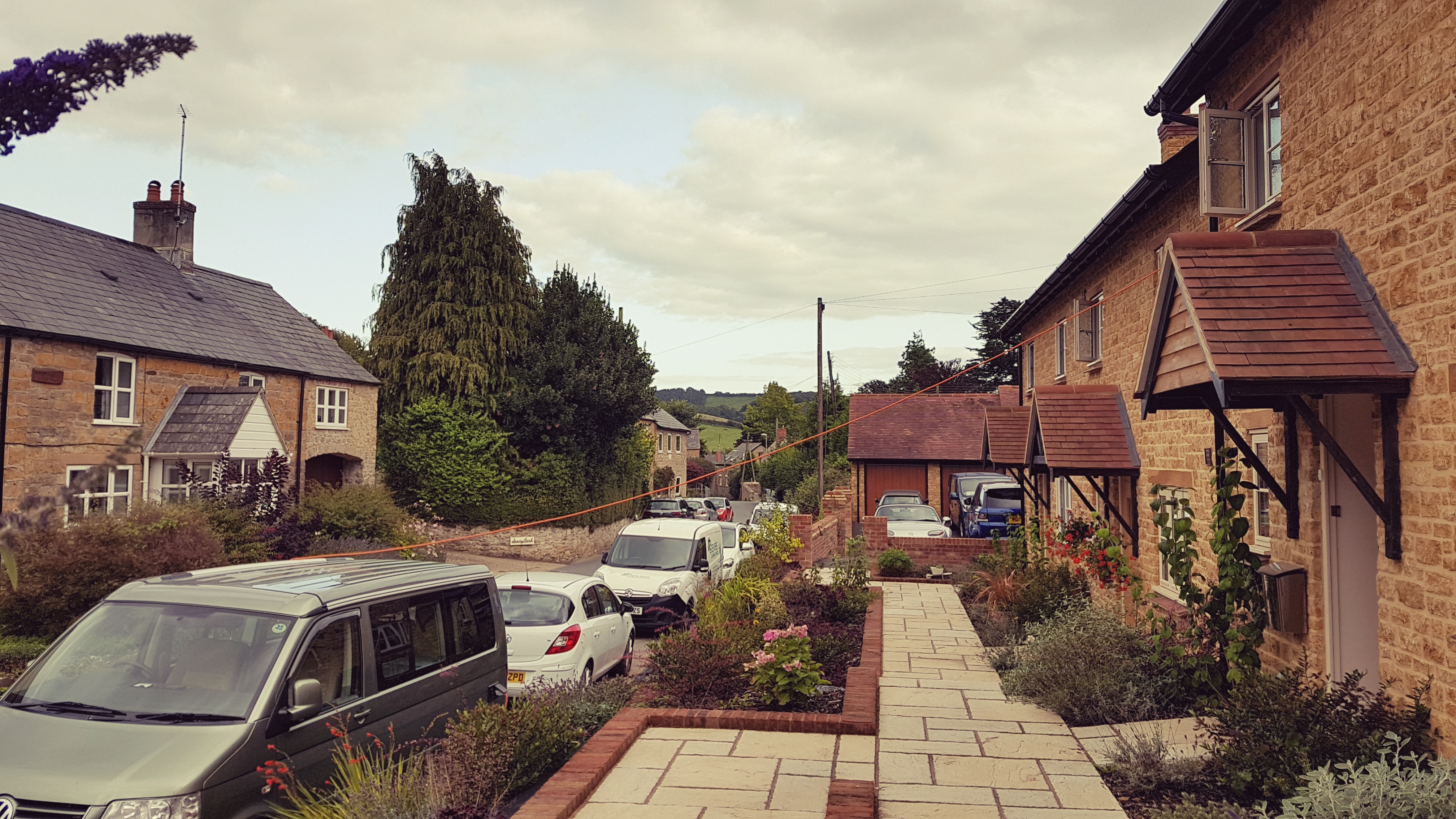

Thank you for all your help. This is our current solution:
You can see our garage in the distance...
Lucky you haven't got an "Electric" California.
Well Done.
