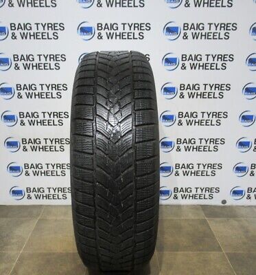

Have you actually tried fitting a wheel in the spare carrier?
I've got a 235/60/17 in mine with a bit of clearance and it may be possible to get your 225/65/17 in. Perhaps a part worn tyre one would go in.
Something like this eg (102 load Ok as a spare)
