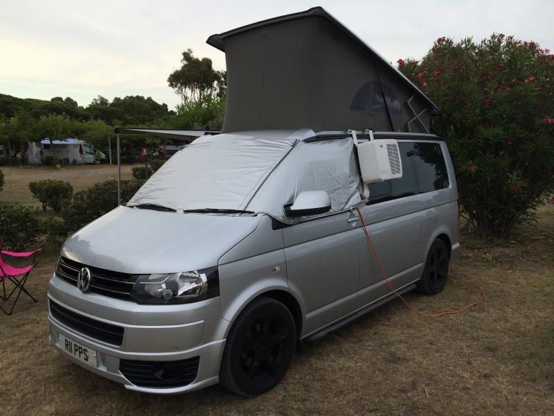

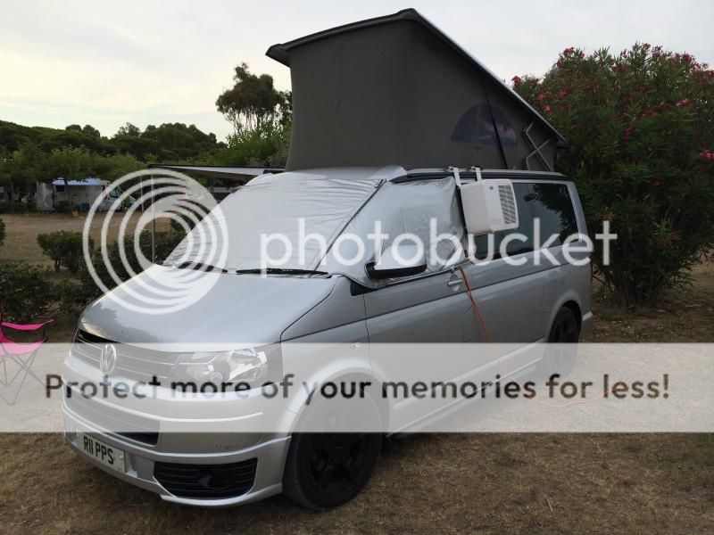

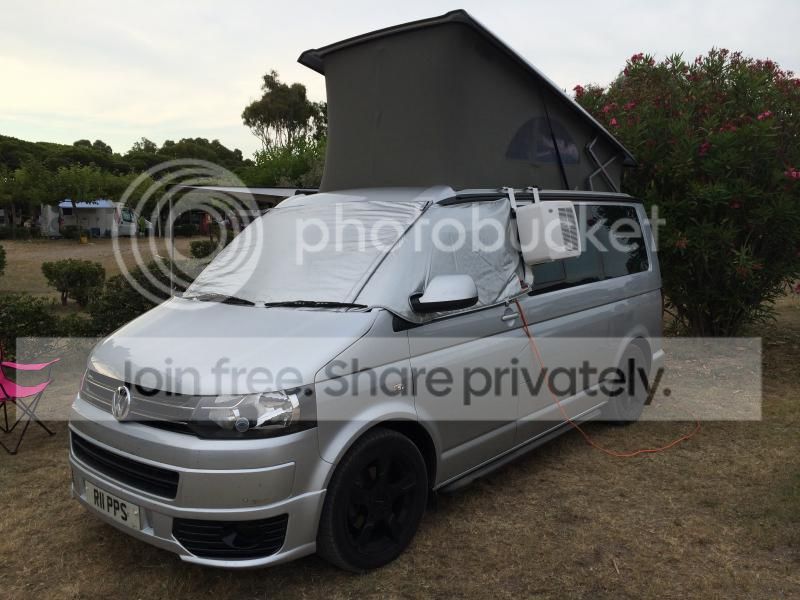

This is our set up whilst we where in Barcelona last year
We saw these units at http://www.coolmycamper.com/ which is a Eurom AC2400 and bought from http://www.ts24.nl/product_info.php/info/7624/Eurom-AC-2400-Caravan-Camper-Airco/ for a lot cheaper.
If you interested I'll go into how we mounted it as it took some adapting. However I wouldn't recommend this unit!
This set up come with two units which are very big and heavy to transport and they are attached together permanently by an annoyingly short umbilical cord, so you need two people to move them about. Our set up despite looking a bit Heath Robinson worked really well and the van was like a fridge! however the unit only lasted two nights (into our 2 weeks trip) before it leaked its coolant inside the van! lost its charge then basically turned into 27kg dead weight that took up half the boot and was in the way for the rest of the holiday.. not happy to say the least. Was able to eventually return it for a full refund thou when we got back to UK (after berating the Dutch company on Twitter!).
We are going back to Spain again this year and honestly I wouldn't bother with the aircon unit in it again. We were in Southern Spain in August and thought we would die when that aircon unit packed up and to be honest it was actually ok. We had a 12v Fan down stairs which got the air moving and upstairs with the windows unzipped it was like sleeping outside.
