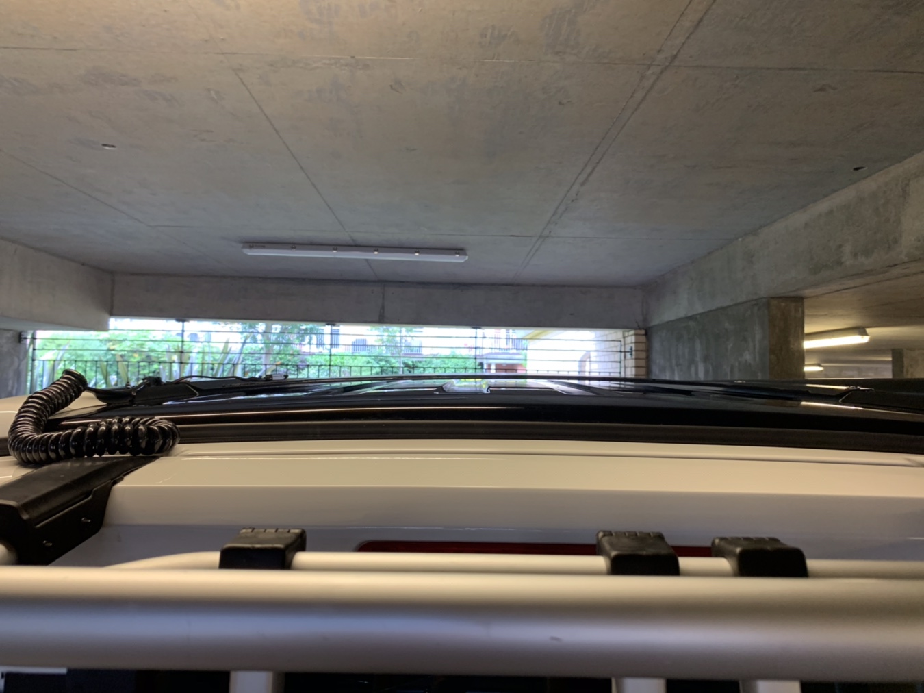

Just installed my all black 110w Solar panel - Thanks Roger at Solar Camper Solutions for your patience with my questions and such comprehensive instructions.
I THINK it works but it’s absolutely tipping down so not much anything is being generated!
I made a template and had a local company make the aluminium plate for me. I just need to tidy the wires (clips arriving tomorrow) and make sure nothing falls off.
That is a slick looking well designed mounting panel.
What thickness is the Ali panel ?

Thanks. No - the panel IS already on it - it’s an all black panel mounted on a black plate.
I’ve got some self adhesive clips arriving tomorrow to tidy the roof cables and I need to secure the charger which is just resting in the jack compartment at the moment - I’m going to use Heavy Duty Velcro for that but leaving a gap behind it for cooling.

Thanks. It’s 3mm thick, black powder coated aluminium.

Looks fab and much nicer than L shaped aluminium bars. Is the curve rolled into the sheet or did you simply bend it up when fitting?
Thanks, it has curve rolled into it to match the roof contour.
