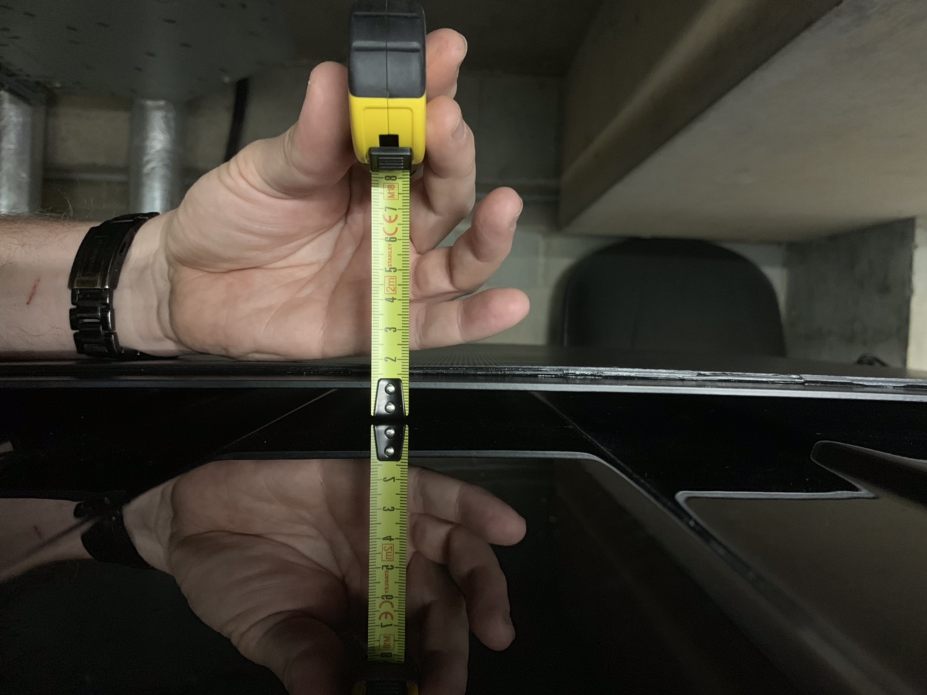

What's the gap between the curve and the roof line? Is it rigid?
I padded mine out with some larger foam strips as my panel started to sag a bit.
Me five.
The panel has curve rolled into it but under its own weight it will flatten. When it’s bolted down to the channels it arcs back to its intended shape and due to the angles of the plate it won’t sag down so long as it’s bolted as the bolts stop it expanding its width.
I think it’s probably 10/12mm above the curved roof. (Will measure and take a pic for you).
When glueing the solar panel on, it had the weight of the solar plus 9kg of water bottles spread equally across its width. No sag. Stu

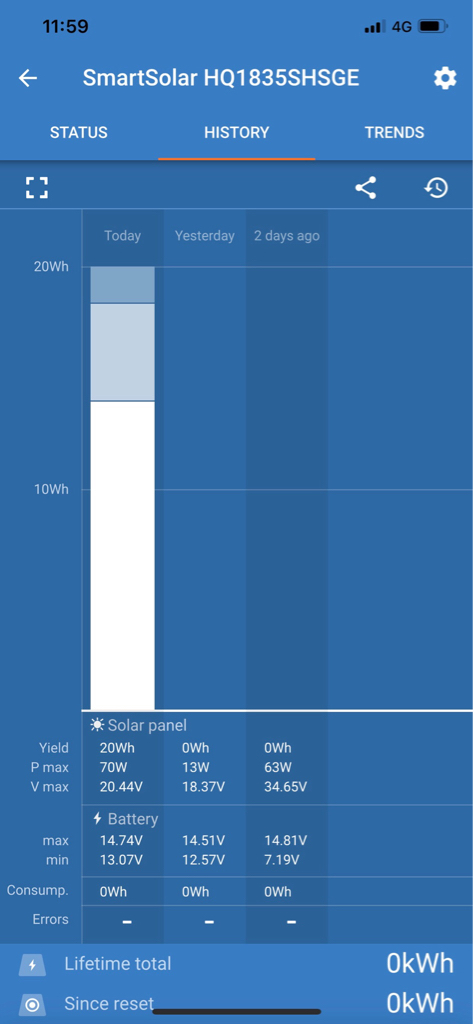

I have two 120w panels and I get about 160 which seems normal according to Roger.
So about 70w on your panel sounds right.

Hi @kave
I just popped to the high street for a haircut and the sun must’ve come out. Does this mean it hit 70w? You were bang on if so - do the lottery tonight!
I’m pleased with the result but she cut it a bit short I think.
Btw, are our leisure batteries AGM ‘spiral cell’? (Comes up as an option on the app)
I have always left my victron on the default setting believe it should be fine but others may know better.
That is good because the bandings show its going into different charging modes with the top banding basically meaning its gone into float charging which is a sign its close to full.
Sorry just updated teh above I think it goes three cahrging states shown in tha tgraph; Bulk/Absorption/Float
As promised, here’s the photo. It’s approx 10mm.
That's great. Thank you.
Ours has foam padding on it so that the aluminium frame doesn't rub on the roof.
Your design is much better and clears the roof completely. I'd certainly be interested in costs for this.
