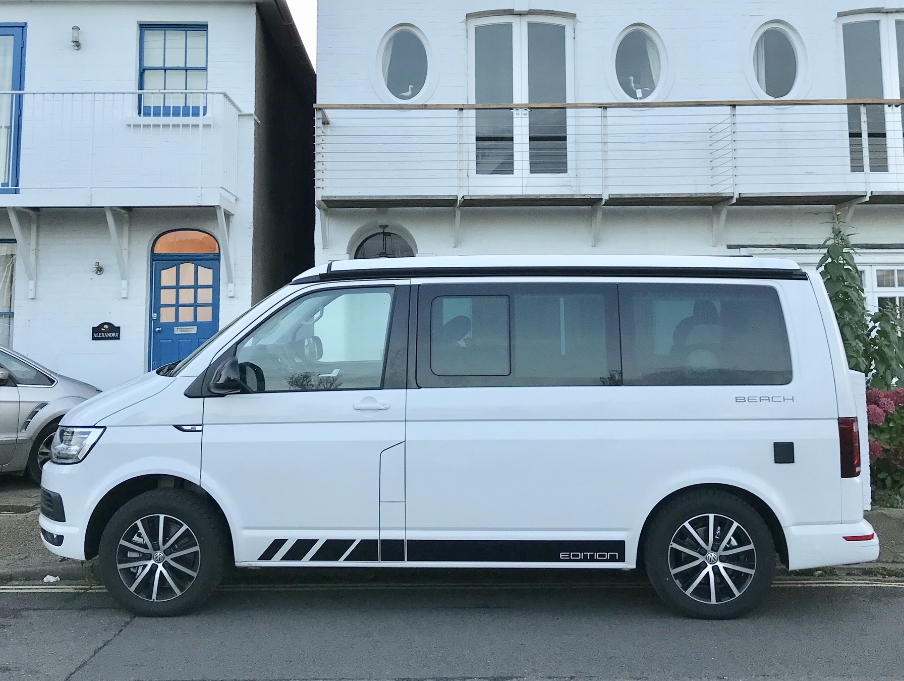

Here’s mine NOT lowered - thought I’d post given its similarity to @Jay17cali
