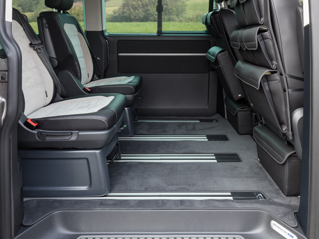

having seen this on the club shop:
does that mean that in theory the rubber matting we have in the passenger compartment would still fit?
That link is to a caravelle one which doesn't have the sightly changed bed position.
I would have thought a rubber one should be ok - don't know how it compares lengthwise with the Brandrup mats.
The extra 50mm makes a difference as without it the middle roller under the draw/bench drops off the end of the carpet & could catch it rather than roll over it when the draw/bench is moved forwards. Its not a major problem if it happens just annoying.
A rubber mat may well be thinner & lay flatter than the carpet anyway which would stop this happening.
Just checked with the club shop and they don't think it will fit - but there is no alternative at the moment. might have to look into getting something custom made as I don't know how carpet will fare.
Looking at the set below from the club shop I realise its carpet but its easy to explain with a picture!
The top cab part won't fit without cutting around the footrest/centre bulge in floor
The middle bit for a T6.1 the three fingers hanging downat the bottom of the picture thats under the bench should ideally be 50mm longer but I am 100% sure it will still actually fit.
Bottom boot bit will be 50mm too long - needs cutting off the top edge.
If you go for a mat that doesn't tuck under the bench a T6 one would have a 50mm gap between the edge of the mat & the front edge of the draw.
