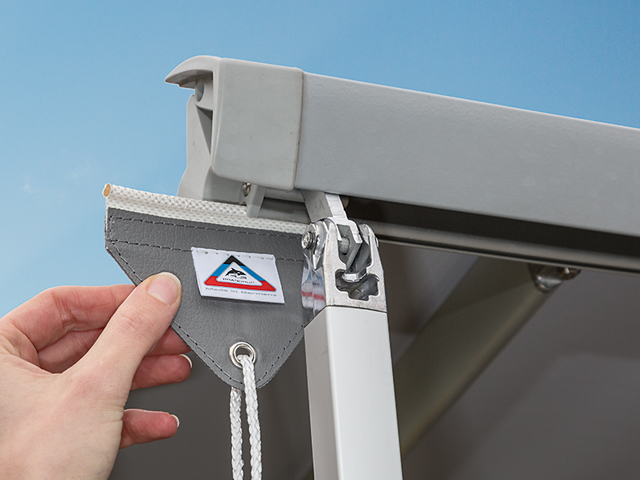

When thinking of using something flexible but strong for the insert suddenly came up with 3 core round electrical cable of the right diameter - works great! My wife hemmed the tarp over a couple of inches first then we hemmed in the cable length really tight by first using a smaller diameter wooden dowl rod as a guide and then slowly fitting in the cable - feeds in the Cali awning easily.

To be clear on the actual sewing in cable bit - if you try and sew with it in place you cannot get close/tight enough so leave it aside and use a slightly thinner wooden dowel or similar in it's place while you sew, moving this along as you go as a guide. Then the 'tube' created should be a nice tight fit for the cable which can be fed in. We practised on the material instruction/safety leaflet first.

The cable makes a 'P' shape in the material (like a Kador strip) and this slots into the rail on the outside of the awning.

Many thanks, I've seen that other thread, and while it looks very good, the material wouldn't be right for us. We want a total block. I'm going to have to open up my awning cassette to look for where this 'kador' or 'P' slots in. I can't immediately see how it could attach to the outside?
Not an issue in practise. See first pics of this topic.

I found the Kador strip quite a tight fit the first time I pushed it in, so lightly rubbed a bit of candle wax on it which seemed to help a lot. My awning is a Fiamma from Nick at Everything California so will be a different Kador attachment to the factory awnings. Thanks for the idea in the first place :thumb
