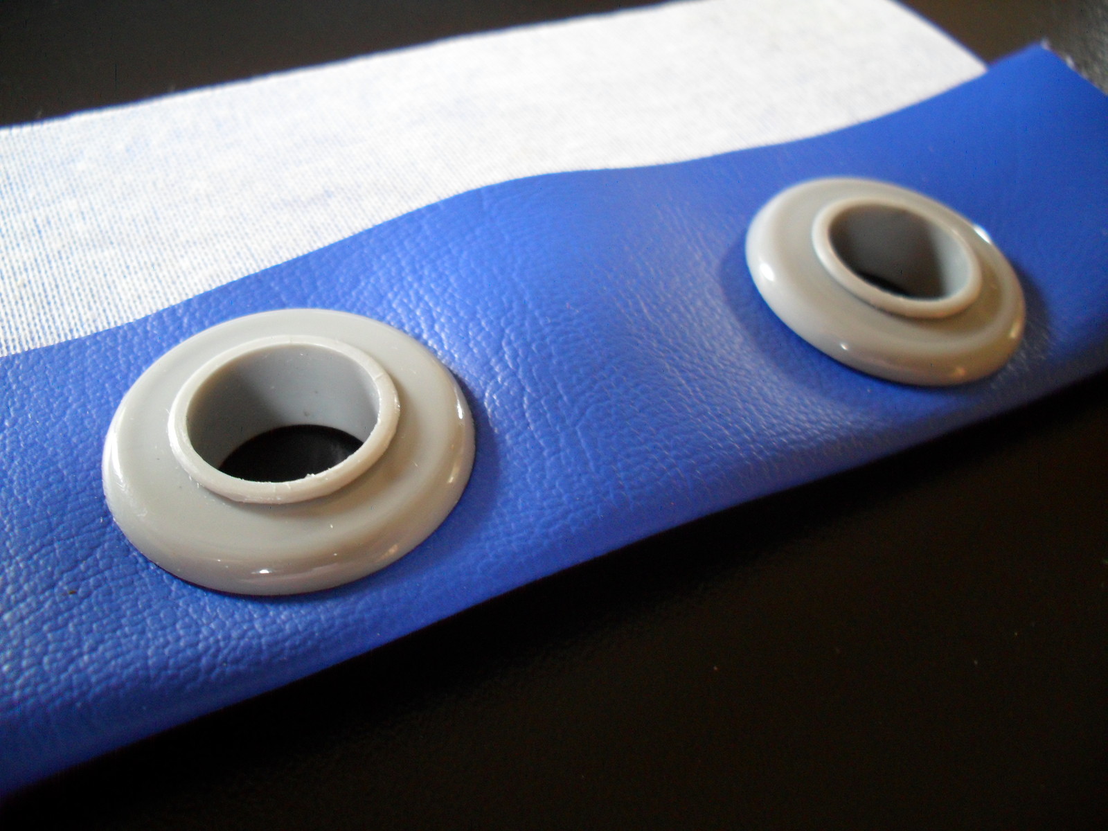

For attaching to the sides or modding the tarps these are useful parts: 'ball bungees' and 'plastic eyelets' - search on eBay:
+1 for bungee balls. They work a treat. How robust are the plastic eyelet holes?
Very - the material is always the weak point but you just need to at least double if not triple fold it before fitting the eyelets. Plastic are better than the older brass type as they spread the load and don't cut into the material like the metal used to.

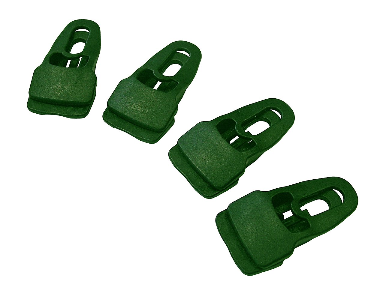

We bought the peggypeg crocs to attach to the awning. Didn‘t have the chance to take a pic.
