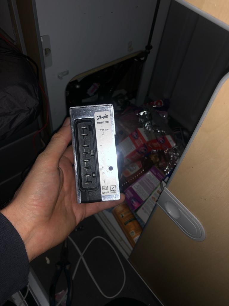

Right- I’ve done the diagnostic thing for the fridge and it came out as 5 beeps which according to the blurb means the compressor is overloaded & to send the controller back for testing… does anyone have any experience with this?
Wow ok getting the controller out is simple when you know how… not so much when you’ve never seen a side entry 3 prong plug before though!
So the replacement controller is the 101N0212 costing £160… wondering if it’s worthwhile sending the old one back for inspection or just ordering a new one…

I’m about ready to throw in the towel trying to fit the controller back on… very fed up. I cannot work out what keeps blocking me from sliding it onto the metal bracket!
It’s plugged in- and so I’m very tempted to just wedge the thing in with thick foam… if anyone knows the trick up getting it back onto its metal bracket please do say.

Thanks very much Marc- I’m resolving myself to using thick foam for now until I remove the whole fridge unit in the future. Thank you very much though!
The good news is that the fridge now works!
@JohnVZ , I would avoid thick foam not knowing how hot that area can get and foam can melt. If you cannot peek inside, use the phone camera to take a few pics of the inside area and then analyse the pics to see what is stopping it from slotting into place. A drain hole camera is also a good investment. Not very expensive off +amazon+amazon+amazon+amazon+amazon+amazon.

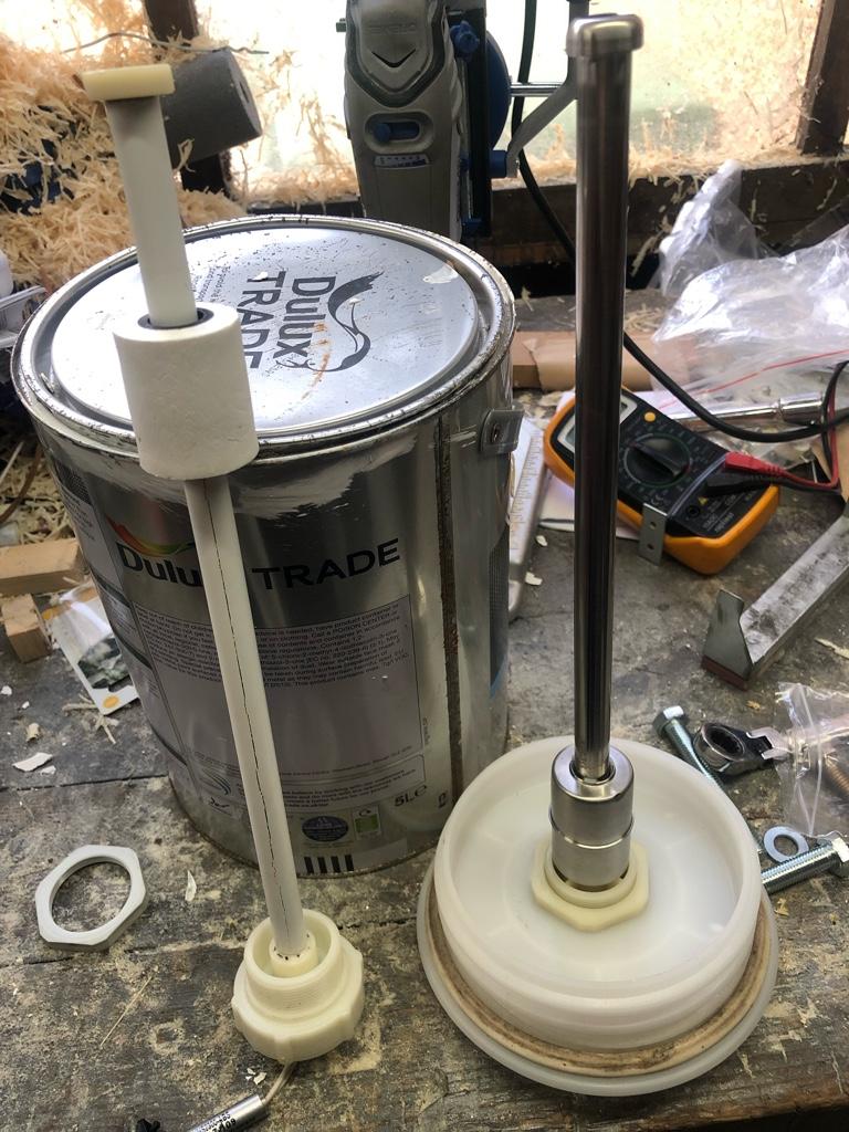

Finally got round to replacing the water level meter… nice little crack down the side of the old one!
And now the water level will finally registers empty! Yay!

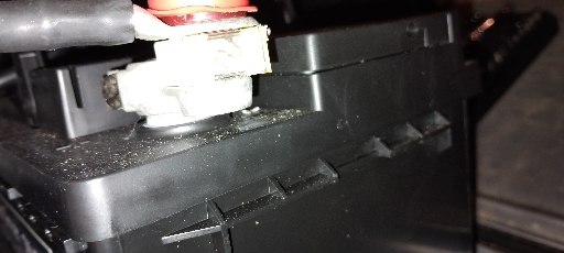

I put a 75a cube fuse in ours and I’m sure that was there from new in 2018. You need to make sure that both leisure batteries are fully charged before you reconnect, as the equalising current could blow the fuse again.

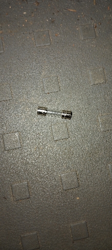

The Mains Charger has an internal glass fuse. The holder is alongside the Mains input plug.

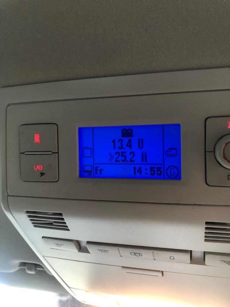

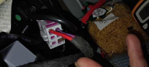

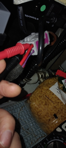

Right so I've checked the green 30a fuses under the front passenger seat and they're fine.
I then pulled the glass fuse and it appears to be fine too!
I thenb plugged the mains charging cable into the van and then tried the multimeter on the wires coming out of the charger box and I got 12.8v..
Erm... Ok.. I'm a BIT stuck here... If the charging box is producing 12.8v.. why isn't the symbol on the display showing that it's plugged in and charging?
Sent from my SM-A057G using Tapatalk
