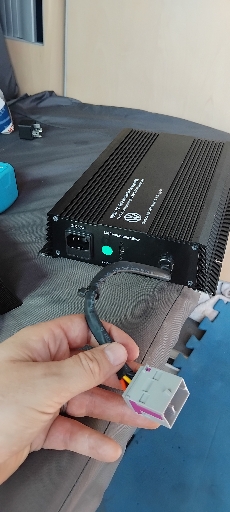

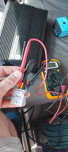

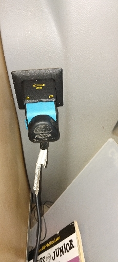

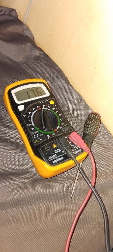

This morning I did further testing - I plugged the mains charger directly into an mains plug, and then tested the output from it by the kitchen sink 230v output place..AND I'm only getting 175v... Sooo... My volts are disappearing between the charger and the output plug.

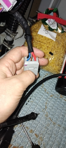

And thinking about last night.. the voltage on the pins coming from the charger should be much higher than 12.8v!
So that leaves me with the relay (arriving Friday/sat) or a new mains charger?

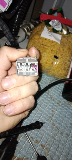

It's just occurred to me that if there's a pin layout/voltage output diagram for the charger output plug I can measure each pin exactly..
I've tried testing the two fat pins (red and black) which I'm assuming pass through the 230v to the kitchen socket and there's nothing coming out of them...

So the repair people came back to me:
"We can check and possibly repair this Volkswagen Philips inverter for you.
The research costs are € 30
The costs for the repair are between € 150 and € 200
The research costs will be extinguished if you agree to the repair
Repair time is approximately 4 to 5 business days"
Sooooo... Max cost is 200 euros plus shipping.. I suppose that's reasonable?
Sent from my SM-A057G using Tapatalk
Right... New relay arrived.. it's a Bosch equivalent https://www.ebay.co.uk/itm/31597854...FOx8hr6Rnu&var=&widget_ver=artemis&media=COPY
Unfortunately still no change in the charging situation, it was a long shot as there's nothing coming out of the charger/inverter thing.

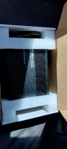

I've found a "new in box" one on eBay which should arrive on Wednesday which is the same cost as getting my old one refurbished...
So fingers crossed it'll be working come Wednesday!

Success!
My new in box type B model arrived this morning and having tested it I fitted it and RESULT!

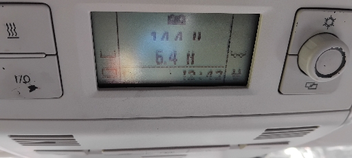

And yes I know my display is knackered.. that is next up on the fix list!
Thank you to all who contributed to me getting this resolved.

DiY repair for Control Panel Screen
Or there is a UK company, also a Forum Trade member who can repair them
Brilliant- thank you for this. Will likely go for the cheapest option to start with and hope I don't damage it to the point of non repair..
