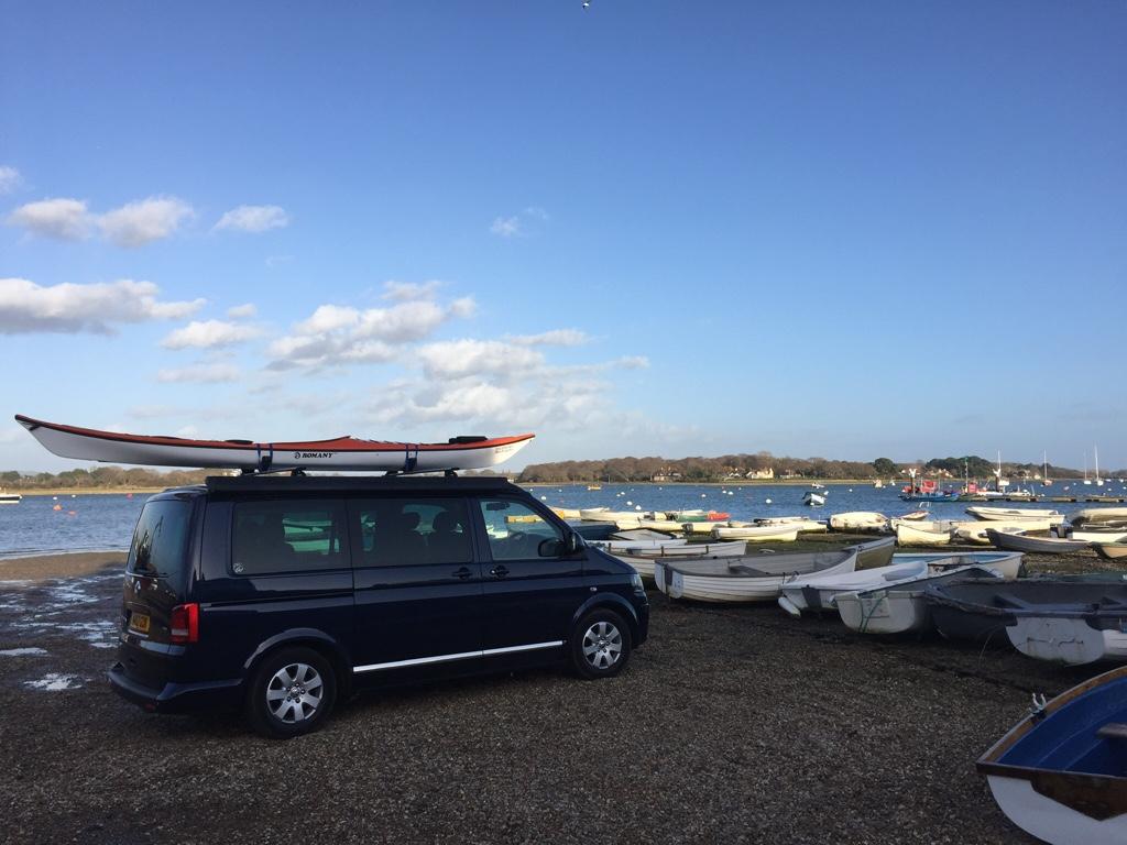

Ive had my kayak up on 753s- it was very close but did open ok - with bow to rear/ stern to front
I think it depends on means of mounting too, j bars etc. I had the boat directly on the bars- but needed to push it slightly forward due to the bike rack ( no spoiler )

This is on the lower foot pack. Kayak is on the VW kayak support cradle which raises the boat about 3 to 4 cm above the bars. Tailgate raises fully without touching the boat. If I have the bike rack on then it does touch but still ok to open and get at stuff in the back. (Atera Linea bike rack rather than the VW one).
That’s great with the kayak that turns up on the hull at bow and stern. I have a Canadian that sits on the gunwales and the bow and stern curve down. That said even with the bike rack on I could always get access into the boot.992AE533-87E4-458C-84EE-CA310EF55F21.jpeg

There is plenty of room to move it forward to open the tailgate. (11’6 SUP)IMG_0054.jpeg
