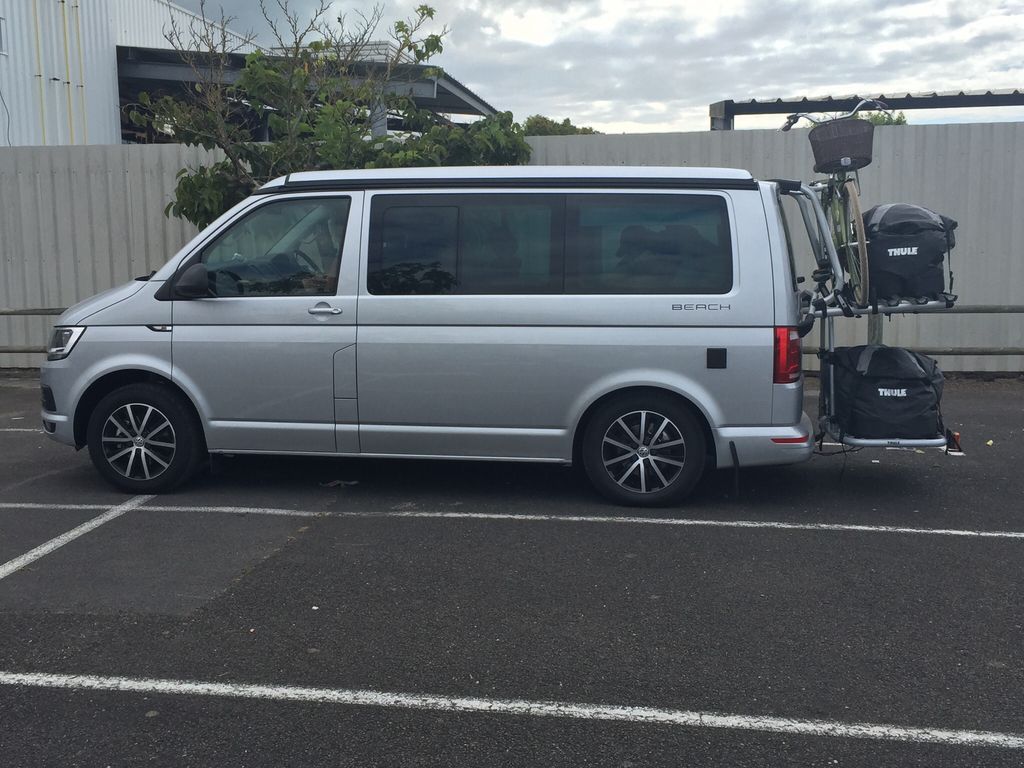

So we took a gamble and went ahead and bought the Thule EasyBase. It didn't look as though it would work as the bar at the back is taller than the lower part of the bike rack, however, when it's packed with a weight it is pulled forward of the bike rack and works brilliantly. We just drove the length of France in a day with four bikes on the rack and the massive Easy Base soft bag full of camping gear, oh and four surf boards on the roof. Obviously you can't open the boot with it installed but if you're after storage it's a brilliant solution. Easier than towing a trailer. If I could work out how to upload photos I can show you what it looked like fully loaded.

Hi, does the Easy Bag fit on the genuine VW bike rack please?
Yes it does, in the summer I was able to get 1 bike on the rack and an easy bag on the T6 rack.
On the T6 rack you can simply slide out the wheel clamps.
On the T5 rack you can just sit the bag on top.

You may have seen this but it shows how it is used. I've got one and use ratchet straps over the top of the bag when loaded, belt & braces. You could remove the bar completely or get a lower height one made up from alloy tube such as a TV aerial mast. Need a pipe bender to get it done properly.
Remember to keep to the 45kgs weight limit.

A pic of my set up.
