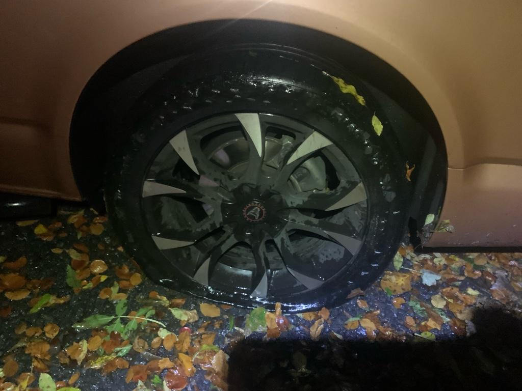

One burst tyre on a dark night on a ridiculously bad pothole that looked like a small puddle in the dark. Submitted a claim to the council for that one but not holding out too much hope. Actually think there might be slow puncture on front tyre on same side which I should get looked at, it needs topping up worryingly often.

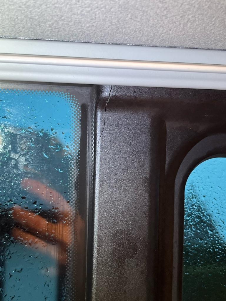

- crack in the plastic surround of the sliding window. Seems to not be getting worse, but want to get this replaced under warranty.

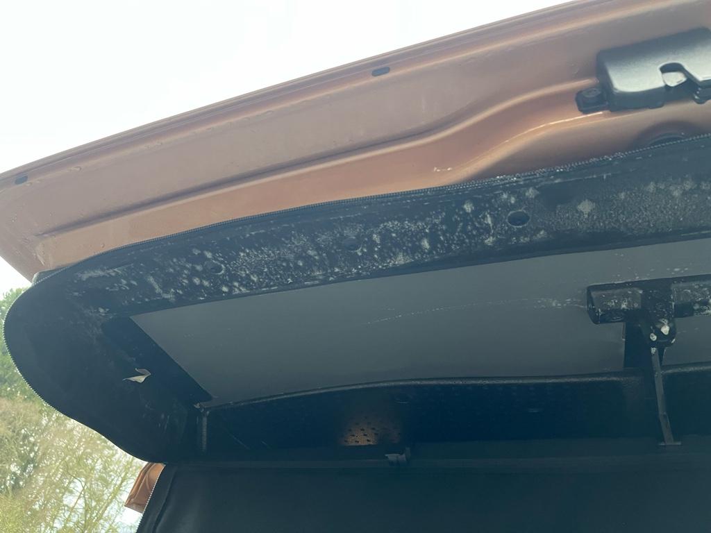

- water getting into tailgate - think this is the common(ish) issue with water getting in at rear top brake light. This was happening for a while before I realised (I don’t tend to need to open the tailgate every day / all that often) so unfortunately the casing for the chairs also went good and mouldy. I opened the tailgate recently to find water pouring out and today removed the rubber lugs so it’ll hopefully drain rather than build up, though just an interim solution.
