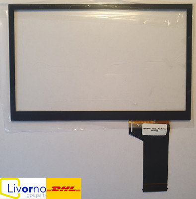

Ok Brett, i‘ve just dug out the the photos, it was actually nearly a year ago looking at them now! Memory a bit rusty but the photos pretty much show the order of things
First the part, here’s the ebay link to the digitiser… no surprises it’s gone up in price like the rest of world. This is supplied from the EU (Germany) but you could take a punt on the cheaper Chinese delivered one (does look a different supplier though). I bought the EU delivered version.
ebay item 115045718856
If this link doesn’t work down the line then just search for “VW digitiser TDO-WVGA0633F00039”
To fit you obviously need to remove the unit, clear the kitchen table and grab your screwdrivers, fairly sure the screws were all of the small torx variety. Then pull it apart to get to just the screen…

Now get your new screen and after cleaning stick it over the existing one with the supplied 3m edge tape. Yes on top of the exisitng!
You will not get the original one apart as it is bonded throughout to the LCD. It is only 1mm thick and will still fit fine. In the last photo it looks like i helped the ‘fit‘ with a bit of sellotape here! Then put it all back together in reverse order but obviously connect the correct ribbon in. I left the existing one tucked out the way hence this is all completely reversible back to your original condition should you need to go back for any reason!
The end result is it looks and performs as per the original ‘working’ screen.
As said been a year now and mine’s performed perfectply.
Good luck, Will

Repaired my screen (digitizer) today (finally...), ordered a digitizer from +amazon+amazon+amazon+amazon+amazon+amazon, costing 14 euro and was readily delivered the next day! Followed closely the steps in the appropriate YT film. It was easy to do and getting the Discover Media out of the car was indeed the most difficult part. Happy Camper again!

This post was so timely, I was putting the old VW head unit back in as hopefully trading our 2016 Ocean in soon. I had put an Alpine Halo 11 in but wanted to keep it. When putting the old VW head unit back on Sunday the touch screen no longer worked! Then, when I woke up Monday, this post was in my emails! I found the new screen on +amazon+amazon+amazon+amazon+amazon+amazon for £18 with next day delivery and it arrived this morning (Tuesday) I then fitted it to the new unit, using YouTube video. I just put it in and works fine! I am no electronics wizard but having done a few stereo installs it was relatively straightforward.
if you are out warranty this is an easy DIY fix for less than £20.

Your description and photographs were brilliant. I followed each one as I went through the process and the new screen works perfectly. One point which may seem obvious but is worth mentioning is that you must connect the grey ribbon on the new screen to the unit not the old one from the wonky screen. Dealer cost £2,500. DIY with your guidance £25 all in! Awesome.

Mine failed while on hols in wales, ordered new digitiser and it was waiting for me when i got home, took about an hour to replace and now all back up and running. Digitiser from +amazon+amazon+amazon+amazon+amazon+amazon 19 quid, just be careful removing the radio surround, start at the lower corners and work your way round, after that its all just screws and ribbon cables.
