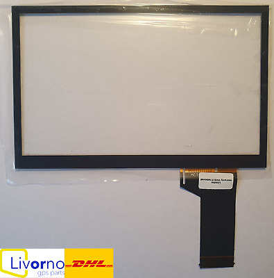

Ok Brett, i‘ve just dug out the the photos, it was actually nearly a year ago looking at them now! Memory a bit rusty but the photos pretty much show the order of things
First the part, here’s the ebay link to the digitiser… no surprises it’s gone up in price like the rest of world. This is supplied from the EU (Germany) but you could take a punt on the cheaper Chinese delivered one (does look a different supplier though). I bought the EU delivered version.
ebay item 115045718856
If this link doesn’t work down the line then just search for “VW digitiser TDO-WVGA0633F00039”
To fit you obviously need to remove the unit, clear the kitchen table and grab your screwdrivers, fairly sure the screws were all of the small torx variety. Then pull it apart to get to just the screen…
No great surprises here, pull off the front knobs, remove any sd cards and just look for the relevant screws…
View attachment 103438View attachment 103439View attachment 103440
Once here you’ll spot a small plastic clip holding each of the two card slot gubbins (below now removed laying on their side, were vertical)
then gently ease up the 2 ribbon connectors and slide them out…
View attachment 103441View attachment 103443View attachment 103444View attachment 103445View attachment 103446View attachment 103447
Basically keep striping it down until you get to the glass unit.
Now get your new screen and after cleaning stick it over the existing one with the supplied 3m edge tape. Yes on top of the exisitng!
You will not get the original one apart as it is bonded throughout to the LCD. It is only 1mm thick and will still fit fine. In the last photo it looks like i helped the ‘fit‘ with a bit of sellotape here! Then put it all back together in reverse order but obviously connect the correct ribbon in. I left the existing one tucked out the way hence this is all completely reversible back to your original condition should you need to go back for any reason!
The end result is it looks and performs as per the original ‘working’ screen.
As said been a year now and mine’s performed perfectply.
Good luck, Will

I bought the replacement screen off ebay for £30. Did the job myself - probably took 1 1/2 hrs because I was going slow and steady.
You need down to sixe TX6 to remove the smallest screws - my screwdriver sets only go to TX8, but I improvised with a small screwdriver for mending spectacles.
For me the most difficult bit is removing the trim. I always think it is going to crack - i used some plastic tyre levers to help with this job.
It works a treat now......:)

Many thanks, WillSS, for your very helpful step by step guide - I just replaced our touchscreen digitiser in a 2016 Ocean. The one dilemma I hit was during reassembly, after replacing the digitiser in the front panel: where to put the 8 screws that secure into the display PCB / front panel, as there are 11 holes ? The answer is to avoid the three gold plated holes (see red arrows on photo 1) - these are for 3 of the second set of 8 screws that secure the metal front of the unit (see photo 2). I only discovered this after putting screws into those 3 holes, then trying to add the metal unit front when it would not go flat because of the screw heads - silly me ! Otherwise a relatively simple job, albeit requiring attention to detail at each stage... probably an hour in all. Thanks again for all the helpful postings here, and best of luck to those yet to do the job !
