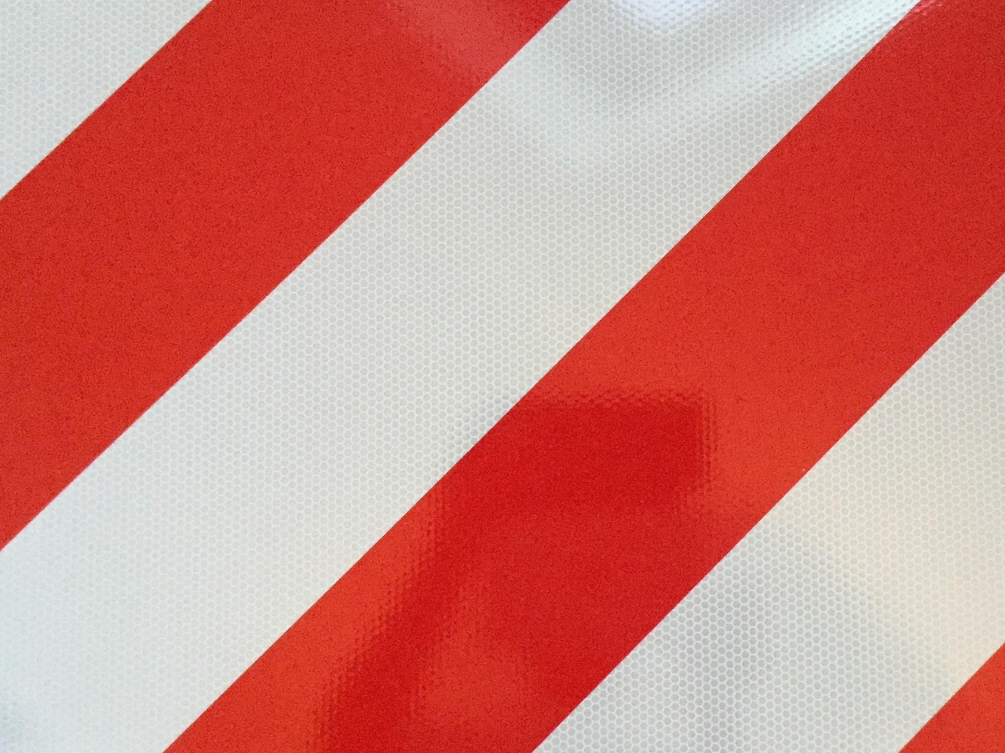

In Spain the warning board must have:
• 3 red/ 3 white hatched, reflective stripes
• a size of 50 x 50 cm
• been manufactured from aluminium
• 4 eyelets for attachment
In Italy the warning board must have:
• 5 red/ 4 white hatched, reflective stripes
That was what my research found 3 years ago.
I’ve got such a sign which is reversible. Sadly I can’t remember where I got it from.

I've just had a look at my two warning signs. The plastic one is made by "Trem" based in Verona, so they should know about materials required.
It does have 5 red and 4 white diagonal stripes and an 85mm dia. round red reflector in each corner.
