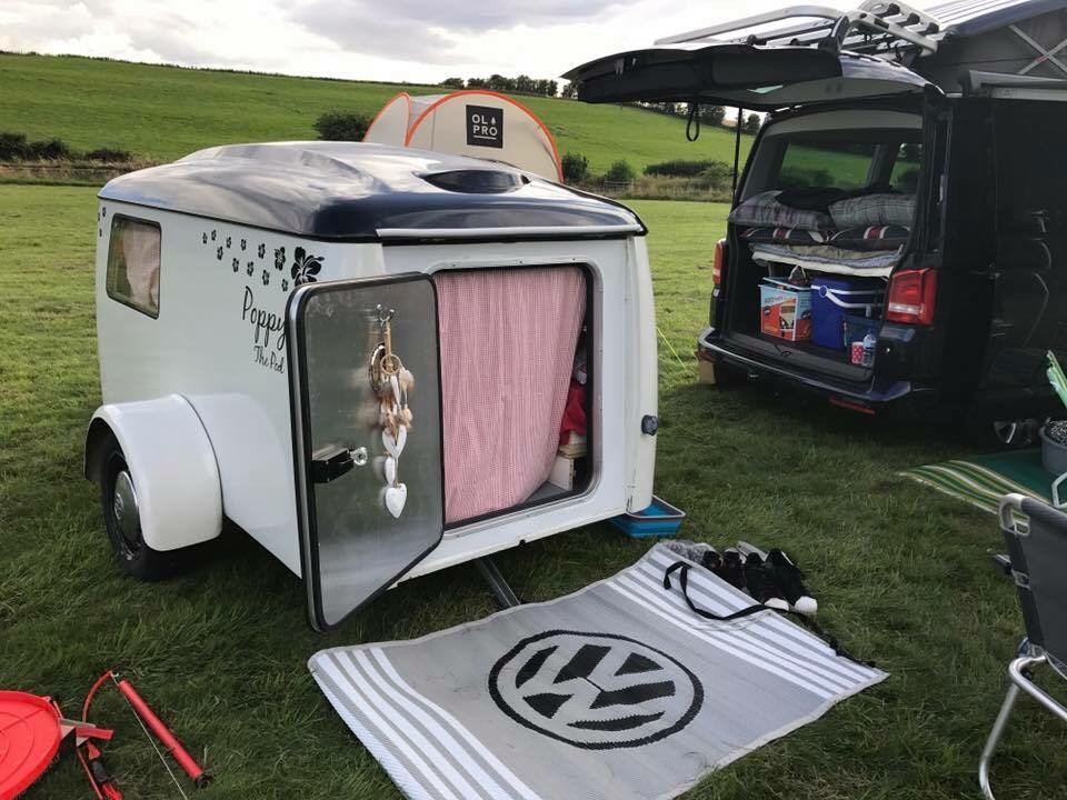

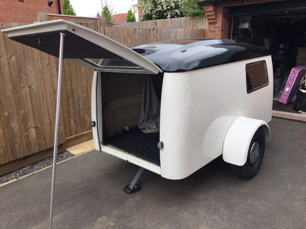

Recently had a tow bar retro fitted to our Cali so we can tow a little camping pod so our daughter can bring a friend along camping with us, I've not tried having the bike carrier lowered so can't help with your question on the gap / space between them.
Obviously our pod is very small compared to a caravan but pulled it with ease, I would say whichever towbar you go for just make sure you have the dedicated electrics as explained above, we went with the westfalia removable swan neck fitted by our local towbar company for less than what VW wanted for just the towbar without fitting costs! Our towbar is the exact same towbar that VW would supply & fit.
We are looking at the Swift Basecamp - more of a pod than a caravan proper but has creature comforts and a warm space for two growing kids. We can get 2 bikes in there but we have 2 more to deal with, and we still want to use the Cali for days out cycling. Thanks Robowagen for your input, we also need a tow bar retrofit.
Our daughter loved her first camp out in the Pod
That is a great Pod! Great rug too. Should have been a thumbs up from me, not an agree!
