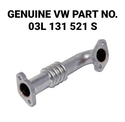

The EGR pipe with a concertina/bellows in it is known to split causing your problem.
There is an upgraded design part now available.
Looks like this
