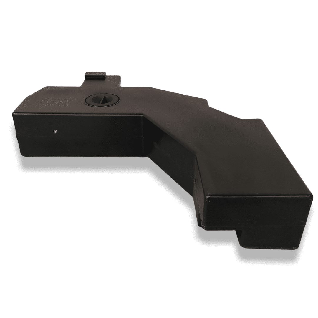

The Beach with two sliding doors is the only model available in Australia and I have ordered the 4Motion. I will make a rear slide out kitchen for it but am keen to save space by fitting the water tank under rather than within. I have a heater and I understand there are not many options for me. Has anyone done this and can provide advice?

All the 4motions have their water tanks inside. At least, that is what appears to be the case. The alternative is to put one in the spare wheel bay and either put the spare on a roof rack or on a carrier on the rear door, neither options appealing.
So I am building a pull-out rear kitchen with a fridge on the left, cooker, sink and storage in the middle and a 20L tank with plug in tap extension on the right.
