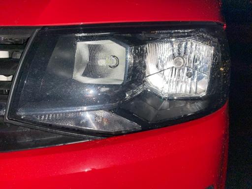

Thanks very much indeed for taking the time to explain the options. Now...how do I work out if I have entry level headlights? I mean, apart from the fact that I sometimes go to turn on the lights at night and find they're already on?
H 4
H 7
