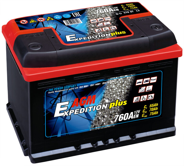

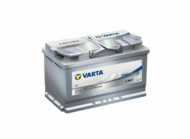

Hi all. Is there any combined wisdom on alternatives to the LA80 leisure battery? I need a pair of them and that's £340 from tayna.
A random search on 75Ah AGM batteries has brought me here, same dimensions (well, shorter but I can't see that being a problem) , 75Ah so same as the original Vartas fitted
A saving of £140 for a pair is not to be turned down - or is it a false economy!

The Varta have a 4 yr Warranty against 3 yrs for the Xplorer.
Also the Varta spec shows 400 Discharge cycles against 350 for the Xplorer
Both will fit.
I got a pair of Varta with 10 or 15‰ off voucher on ebay from Tanya.... It was an ebay only deal and was a proper saving. I tried to see if Tanya could beat it going direct, but they wanted £40 more!
Worth checking ebay for those voucher codes as it may well close the gap to allow you to justify the vartas.

so that's £290 vs £200 now for varta vs alternative :) Does anyone have real experience of the alternatives or should I go for the reassuringly more expensive option?

For £90, I'd go varta for resale value. I had an Explorer battery in my T4 Exclusive and it seemed fine, but Cali buyers like to see them properly maintained (kept as standard).
Just ordered 2 x LA80 from the tayna ebay site - £289 inc delivery. A nice 50 quid saved by 2into1

Update - both Varta LA80's installed along with new ceramic fuse. They're now on charge through the new EHU port that was also installed, but I can notice the difference already - for example the erbspatcher heater starts up when I ask it to, whereas it never used to :)

Update to this old thread. I bought 2 of the cheaper explorer 75aH batteries as described above as the Varta was out of stock. Fitted 2020 and they worked for about 18th months before performance fell away. I fitted a solar charger so didn’t really mind but I have just replaced them with the Varta batteries today. False economy. They are both toast and in a worse condition than the originals that were 12 years old when I swapped them out.
