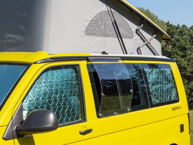

I made a DIY version of the Brandrup air screen

I like the Brandrup Airscreen. Once fitted it doesn't cut out the light and you can still open and close the sliding window as desired. Good for both nighttime ventilation and cooking when it is raining:
Could you post some details of how and/or a photo please
It's a clear plastic sheet from B&Q (can't remember if it was acrylic or polcarbonate)
Gorilla tape to protect the top & bottom edges.
Suction pads that I had from replacing mobile phone screens.
Body clips from an old RC car.
I also put some magnets under the gorrila tape on the bottom edge as I had them left over from an attempt at cheating at scalextric but not sure they are necessary.
Plastic sheet was the only thing I had to buy and from memory was about £15.
View attachment 46374View attachment 46371View attachment 46373
Nice bit of work there :thumb

It does block some light out but gives you fresh air, weather protection and can be left in on site to help keep your Cali a bit cooler, depends how hot your cali is.

Looks very doable. Thank you.
