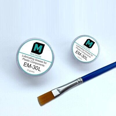

Conductive grease
https://www.amazon.de/dp/B07NGKJPRC/

I think the issue is with the plastic shroud on the male plug having a tight fit against the female socket, rather than the conductors.
If thats the case then silicon grease should help as a long term solution. I little Fairy liquid would be a good way to test.
Worth a try which I now have as I have a wall mounted socket that is getting harder to unplug as well as the Cali end.
Quick wipe around plastic parts on plug and socket (keeping clear of pins) and instant improvement.
Just a little lube used which was easily applied with the supplied brush.
