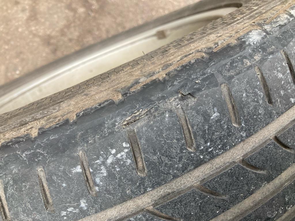

Yes. I did exactly that. I bought a small electric pump, and got it to 35psi. (17/235 tyre is 38/41). Flat in 30 mins.
I repeated this morning, and drove to the tyre place. The inside tyre had been stripped bare.
This is the SECOND time this has happened. I was advised that the 235s must be rubbing somewhere. A quick visual check didn’t determine anything obvious, but the gap between tyre and body is a little tight.
Tyre place pumped up again. I drove home and picked up my well worn but legal 16/215s, pumped up again and returned.
All four wheels replaced for £20.
Those wheels came off in November 2018 and have been sitting behind our bike shed under a tarpaulin since then.
I bought the 17/235s on here with delivery miles only. I gave them to the tyre place for the £20 I owed them. I know I mugged myself, but at least they are disposed of and I no longer have to store wheels under a tarpaulin behind our bike shed!
Just looking at that wear. Is it a rear wheel? I had similar wear on my rears, when I looked closely I noticed I had a broken rear spring. I had put it down to rear end sag that some keep telling us is normal and correct. As I was having to replace spring I took the opportunity to fit T32 Sachs rear springs (4 grey marks) and uprated Sachs rear shocks. Hey Preto the van sits far better and a superior ride. I think that inner edge wear is caused by excessive negative camber caused by the suspension sag.
Thanks for that info. I will have a close look at the rear springs.
My van’s suspension has just passed a “vehicle health checkup” at SMG Tonbridge, so I will be a bit annoyed with them if they missed a broken spring!
