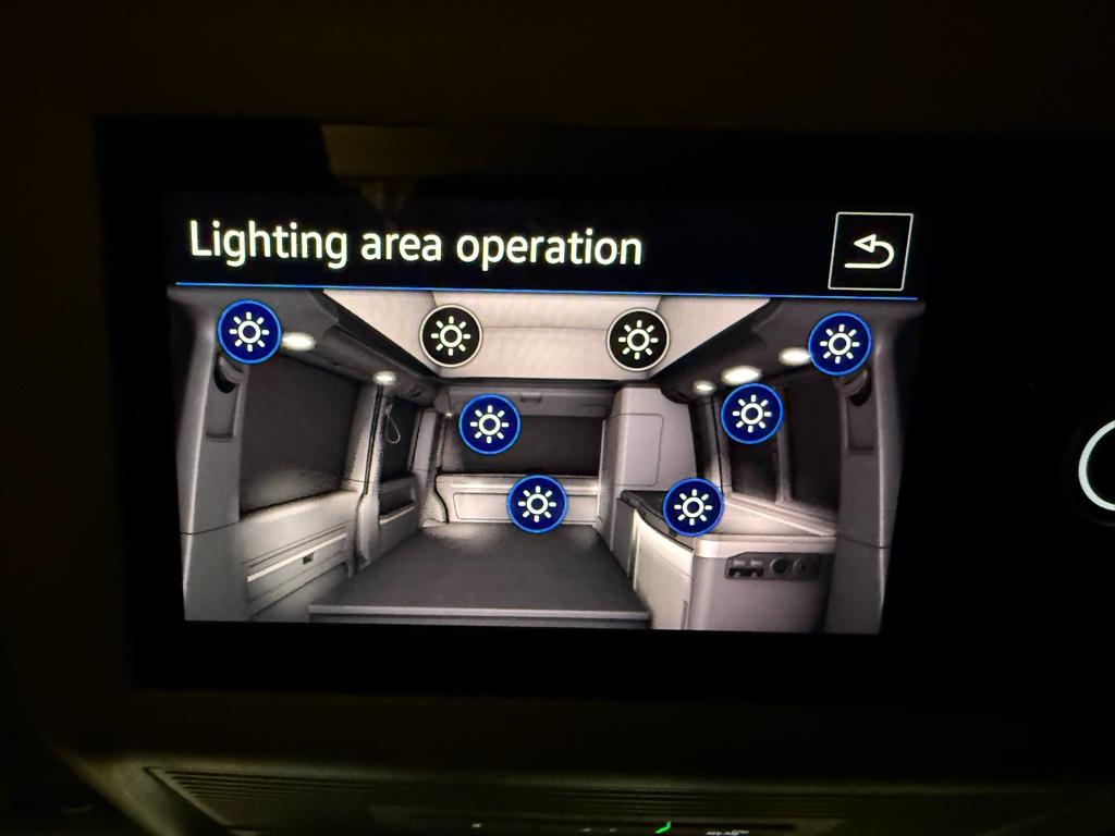

We put the roof up to show the top bed etc (which we haven’t used yet). I used the control panel to put the pop-top lights on. The passenger side light came on, then flickered and went off, the driver side wouldn’t turn on. I tried the physical switches for both, but neither worked. I made a mental note to check the fuse, and took photos of the lights and control panel thinking I might post for advice here.

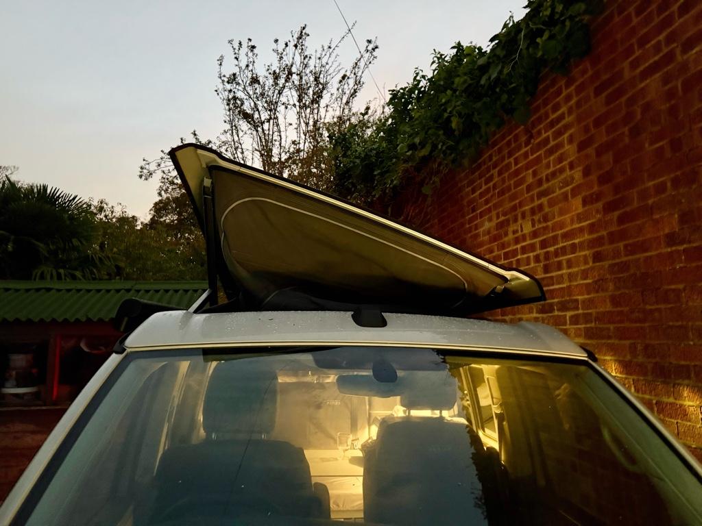

After sitting in the van and chatting for half an hour I went to put the roof down, and all appeared to be going smoothly as I started to gather the canvas. At roughly half-way down I paused and asked my wife and relative to do a visual check outside to make sure no canvas was snagged etc.
They went out and shouted that the roof looked seriously uneven. They were right, it didn’t look good. I hadn’t noticed from inside as I was sort of covered in canvas.
Having considered for a couple of minutes, we put the roof back up, and then brought it down - with the others outside checking things. This time it came down evenly.
I sent this photo to Breeze, and it’s going in for a couple of days in a fortnight’s time. I’m not to use the roof before then. I really hope the roof itself, and the scissors/hydraulics aren’t damaged, but the lights not coming on is perhaps an indication that there was an issue?
I think you have an hydraulic pump failure on yours and I'd be surprised if any sagging testing is required.
I'm fairly certain it will get a new pump.
This happened to ours a year ago and we had the roof fully elevated on one side and fully down on the other. No permanent damage to any roof components.
I'll find a picture later.
That’s reassuring to hear - thanks very much!

Reading this thread, I’m still not sure if it does apply as our ‘wonky roof’ issue happened very quickly while putting the roof down. It is really interesting to read however about the lights in the top not working, as that is now ringing alarm bells.
A relative came to visit from Sheffield on Monday. He has a T2 that they have taken to France every year for the last two decades, and he was keen to see our T6.1 Cali.
It is parked on the drive so we went and gave him a stationary tour; cupboards, tables, chairs, hobs, heater etc. You know the drill.
Lights not coming on is generally a sag issue. The lights only activate when the roof is fully up. If the roof sags the microswitch that enables the lights becomes open so the roof lights do not work. One assumes they don't need to come down far for this to happen. If your roof was fully up with no sag and the lights did not work it is likely another issue.
