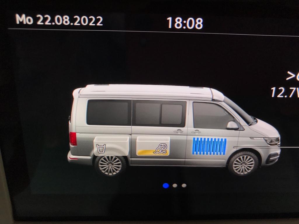

I have a 2021 T6.1 Ocean with I presume a dodgy waste water gauge… No matter empty or full the level on the gauge doesn’t change.
Presumably the gauge should display the water level?
The waste always shows the level in the image.

Ours has always been the same, fairly useless.

If they are using the same sender as in the T5, then it only indicates when the waste water tank is full, no indication of level.
Ours is a late 2020. Exactly the same.
I figure the sink will stop draining when it’s full
Ours is the same. We did fill it (deliberately) in order to sanitise the tank. One second ‘empty’ next second ‘warning - waste tank full’ and the icon showed full as well. 2 hired vans previously were the same. The fresh water tank is not much better.
Does take a while to "catch up". Once full, the display does change to an image depicting a full tank and you get a "pop-up" msg telling you to empty it. The msg requires a touch of the "OK" to make it disappear.
Thanks, I emptied a full tank of water into the waste and no change to the level indicator and no warning. I’ll try a full tank plus if there is an overflow and report back.

Ours is frustratingly the same: always shows the same, even after a good emptying!

Our shows the same, MY22 Coast. Apparently that’s “how they are”…

Same here on brand new Ocean. Fresh water tank displays the current water level. Waste water tank only ever displays a thin yellow line at the bottom.

I agree. It's just a binary indicator, not a gradual one in stages like the fresh tank. It either shows empty or full. Try to push it further when it shows full and you'll get a pop up msg telling you to empty it. The msg will require an "ok" to acknowledge it.
Well I decided to get to the bottom of it and took the inspection hatch off my waste water tank.
The level sensor is a stubby little float on a short rod inserted through the top of the tank. The float won't even start to move until the tank is almost full.
... so it's pretty much a binary sensor.
