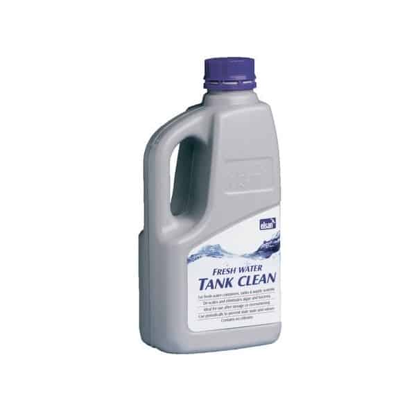

I just use this, from the Club Shop or Amazon.
