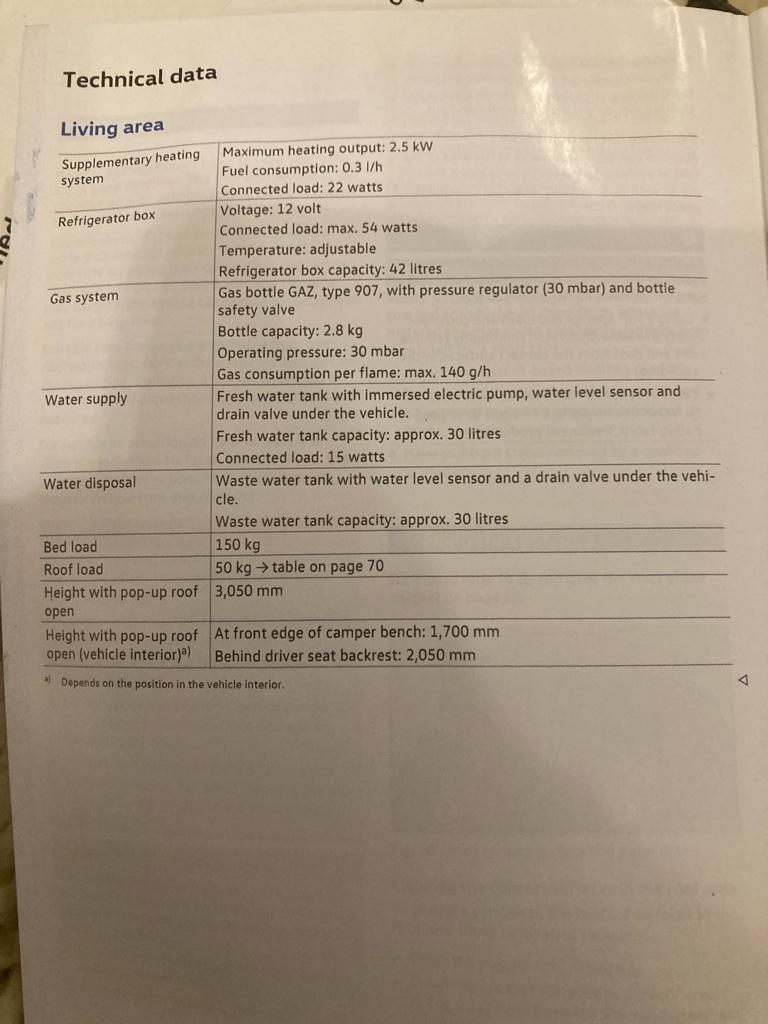

Can anyone shed any light on what’s the maximum weight you can have on the ‘upstairs’ bed please ?
hi all as there seemed no comclusion to the weight limit for the upper bed of tha California Ocean I contacted VW today to ask the question and they replied that it was 150kg.
It is in the manual.
Bed load 150kg.
