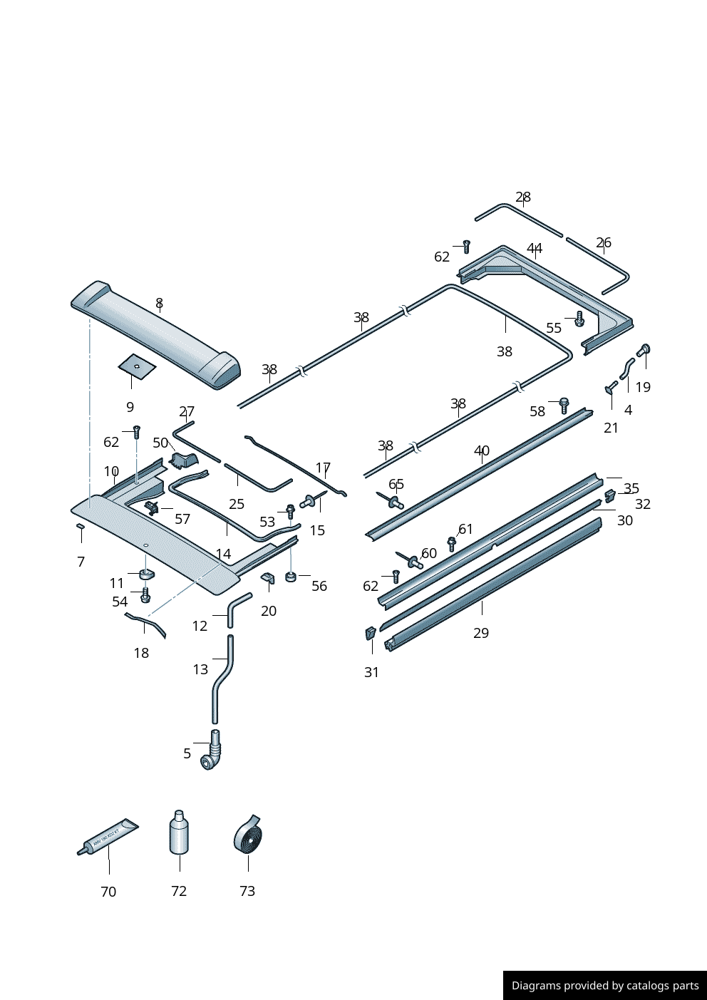

You can see the roof drain is in 4 Parts.
In @Lambeth Cali s case Part 13 had become detached from Part 5.
Same system for both front roof drains.
The R angle join between Part 12 & 13 precludes pushing anything down as it is only a push fit.

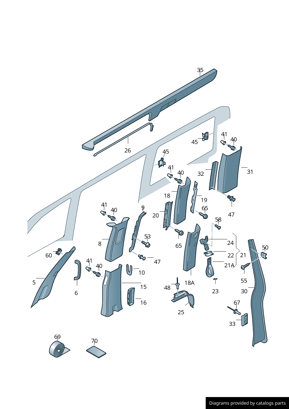

The A pillar trim is fairly straightforward to remove once the grab handle is removed.
Btw Steve perhaps this is obvious but even though Welshgas’ diagram only show pipes 12,13 and 5 on the passenger side, they do exist on the drivers side.
