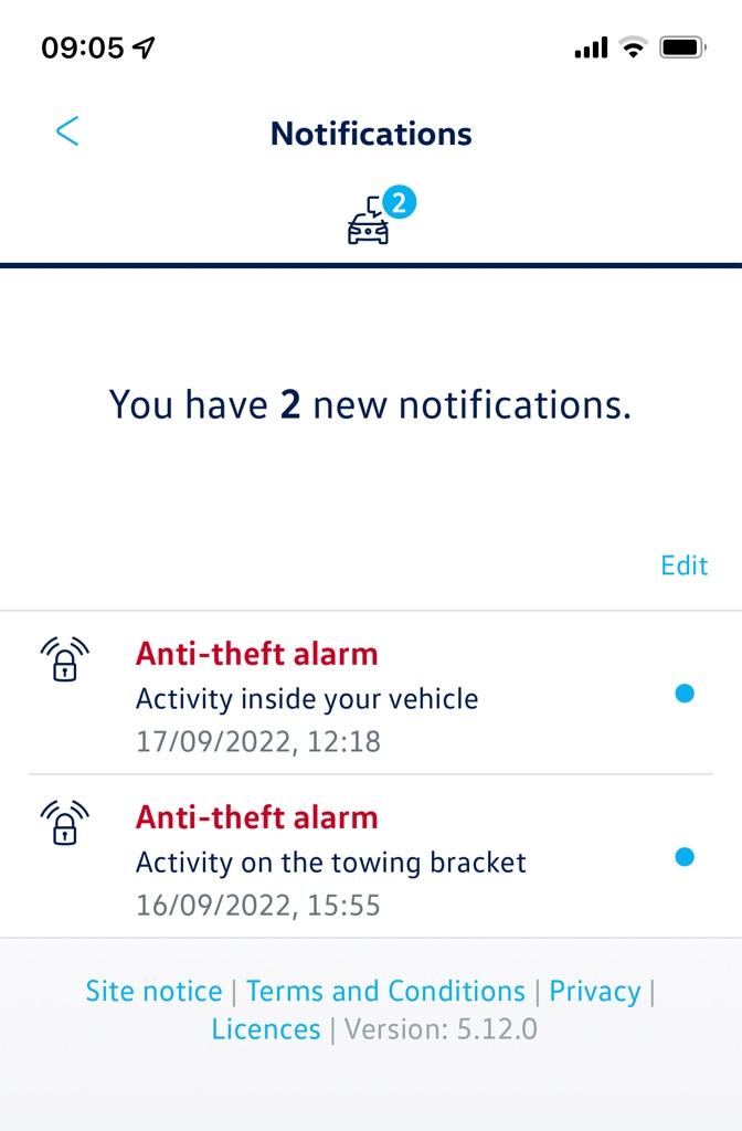

Another thing I didn’t know until recently is if you take your bike rack off while the alarm is set it goes off + you get a we connect notice.
